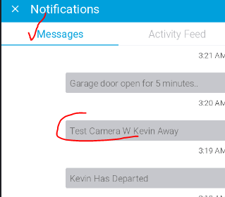

I am not receiving email (notifications) as well… again I set email credentials up in the DLINK app - I do see the “notification” within the ST APP - just no “snap shot” as i expected.
Any guidance? I hope the screen shots help to tell the story.

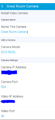

Can you please post your SmartApp settings page for this camera? You can cover up your external IP.
your camera port should be port 80 by default.
OK - it was originally - Do I have them “flipped” then?
Should the Video port be 554 then?
No, that camera uses a MJPEG feed (no audio) so you will use the same port for both.
