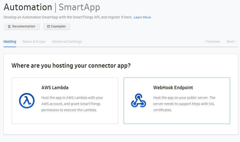

Currently I’m developing a Windows Service App. How can I implement OAuth2 flow that can refresh automatically daily? I tried to create Automation App in Developer Workspace but unfortunately it requires WebHook Endpoint which not applicable to desktop app:

Hi @henoch.setiadi
You need an API-ONLY type of app, and the one you created in the Developer Workspace won’t work because it’s not the correct type. I’m sharing the steps below to help you create the right app.
  1. The option to create OAuth integrations cannot be found in the Developer Workspace.
  2. You need to use the SmartThings CLI to create this type of app
  1. You can also use the JSON in this sample as the input for the command.
