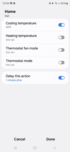

I have a door sensor that I would like to test if it has been open for more than 5 minutes and if someone changes the temperature to reset the temperature to a specific value after one minute.
The app for routines won’t allow me to state if it’s been open for more than 5 minutes do this, best I can do is say if the door has been open for 5 minutes and the temperature is not my value set it to that value, but this does not work if the value changes after 5 minutes.

Might be possible with the Rules API, but there is another way to accomplish the time trigger using the Edge Counter Utility. The challenge for your Routine is that there is no trigger for just “changes” for the temperature. It must be “temperature is above” or “temperature is below” or “temperature in range” or “temperature is”.
For the time trigger, create a Routine to turn on a counter when the sensor opens. Then when the temperature changes and is above/below/in range AND the duration of the timer is at or above 5 mins, set the heat/cool temperature to a specific value delayed by 1 min.
