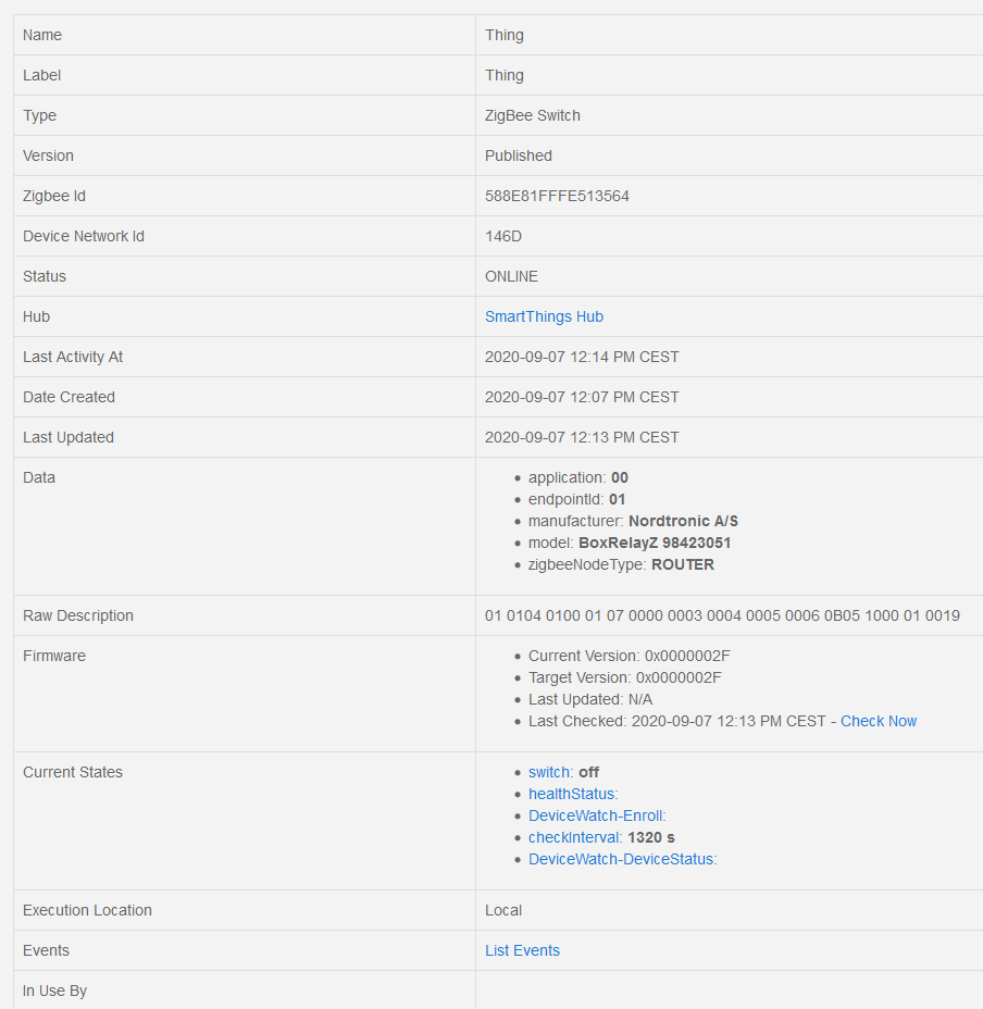

It worked. Added as “Thing” through" the old app and changed type to “Zigbee Switch” in the web UI … Could be nice to have this integrated into the new ST app.

I was able to make it work using the new app as per the instructions given by Nils: 1. add a nearby device as a Thing 2. Go to the IDE 3. Change the type to Zigbee Switch.
I can turn it on and off and, most importantly for me, set schedules.
