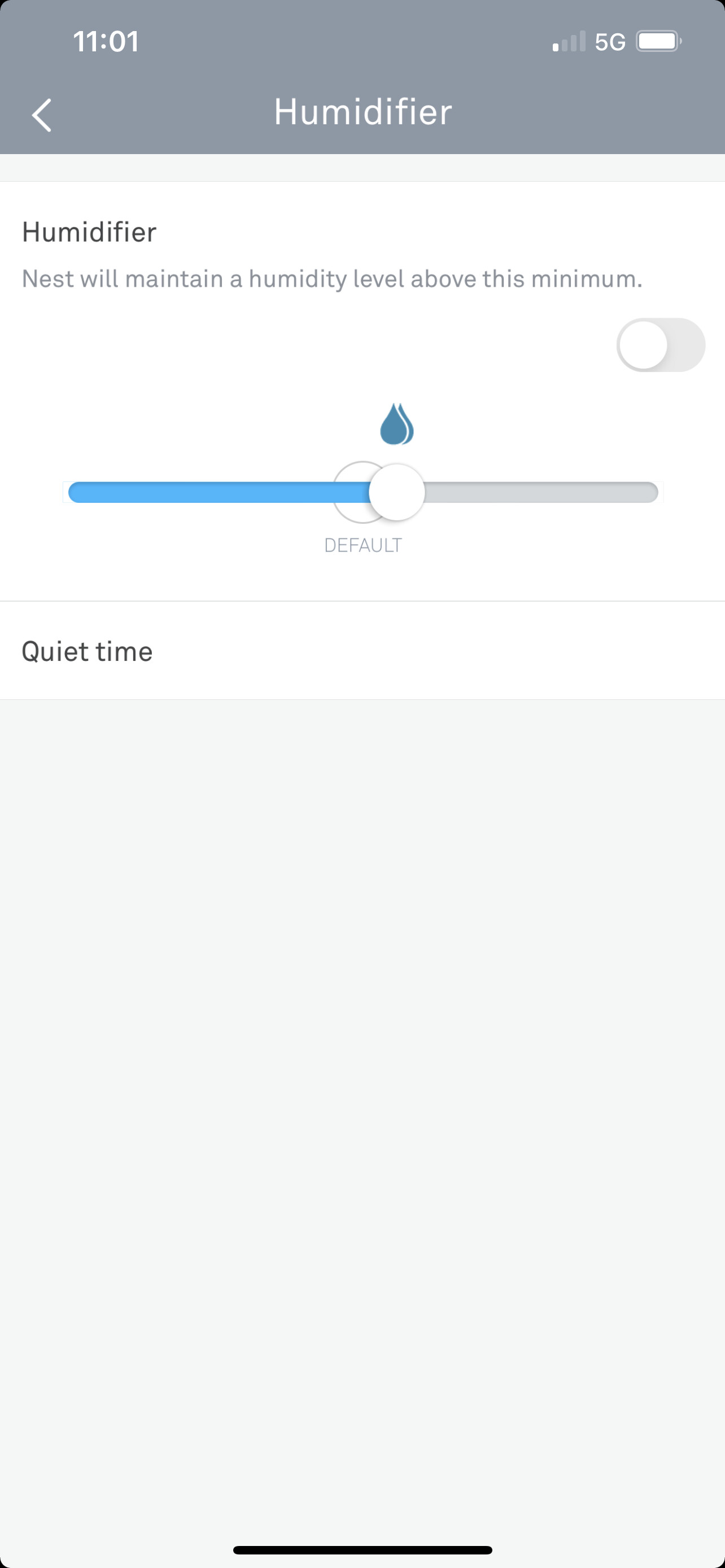

On another note, I am seeing a issue with the Humidity SmartApp, it’s setting the appropriate humidity target but it’s turning off humidification?
The maintain humidity above selector is being turned off by the SmartApp?
Hi, for energy savings purpose, the smartapp may change the “target_humidity_enabled” flag when the ambient relative humidity is within range (+/- 5% by default vs. the target or within your custom range if any provided)…
