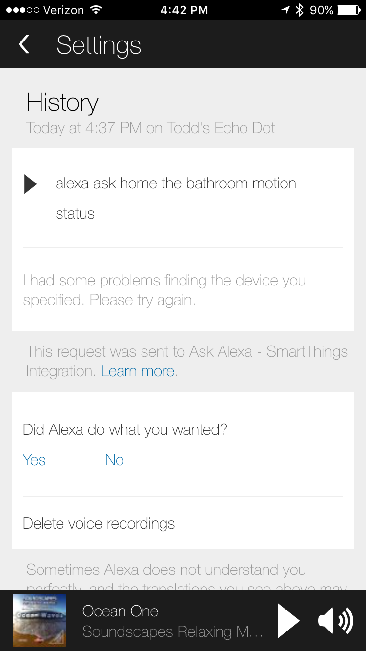

When I try to ask for status of doors and temp sensors, it says it cannot find them. When I go to the URL with all the setup information (or look at it in the smart app), there is no section that lists my doors and temp sensors.
It would see that they would need to be there. Am I missing something?
My temp sensor including bathroom motion:
My attempt to ask for the status of the bathroom motion:
Hmmm…very strange…did you look in your list for custom slots to ensure these devices were in there? I can say the apostrophe may causing some of the issues for those devices, but want to make sure first that the devices were listed in the “LIST_OF_DEVICES”
EDIT Reading your post a bit closer it sounds like they are NOT listed…can you look in the log when running the set up web page to see if any errors are thrown? I would also like to see what DOES come out of your web site list that is generated.

I get a warning:
5:00:56 PM EDT: warn There was an issue parsing the device labels. Be sure all of the devices are uniquley named/labeled and that none of them are blank (null).

I took the apostrophes out and I still get the warning.

Ok…this is the resolve from an issue @Big_Jim had above…I will almost bet that you have one of those devices where the label is not filled in correctly. Some devices do that for some reason…I would go through each device and see what you come up with. If they ALL have labels, try removing the apostrophe from some of the names as the Echo can’t ‘hear’ possessives…just plurals (if that makes sense…it hears “Mikes”…not “Mike’s”)
