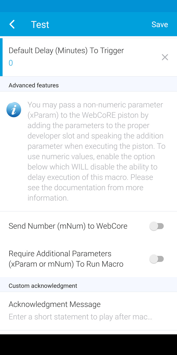

Wait that says non-numeric though. I’m trying to pass a number to use as a temperature setting.
Right…expand the image out and look at the additional options below the rest of the text.
“You may pass a non-numeric parameter (xParam) to the WebCoRE piston by adding the parameters to the proper developer slot and speaking the addition parameter when executing the piston. To use numeric values, enable the option below which WILL disable the ability to delay execution of this macro. Please see the documentation from more information.”
Coming on Friday. Unless you want to PM me
