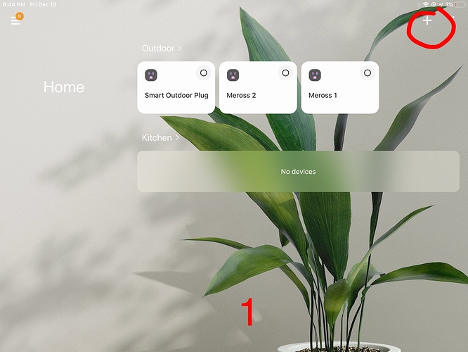

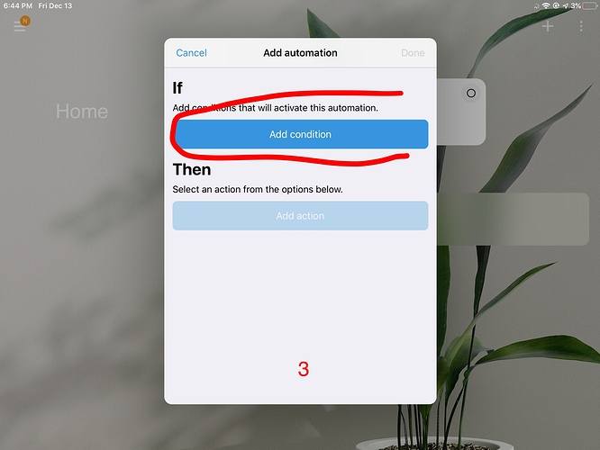

As @JDRoberts mentioned, the app is evolving more rapidly than the documentation. What was once called “Custom Automation” now has its own tab in the app and is simply called “Automation”. If you are on Android, you should see the same thing as posted in above screenshots. Just click the plus sign, then “Add Automation”.

That’s exactly the app I have. Giant plant and all. The items you circled are exactly what I’ve been selecting.
The very next screen - after #4 (“Example - when dad comes home”) is where it stops making sense and looks like choices are missing.
I have exactly the “member is hone” and “member isn’t home” choices. If this is as you say and it really means “member arrives home” then that’s some seriously bad wording.
