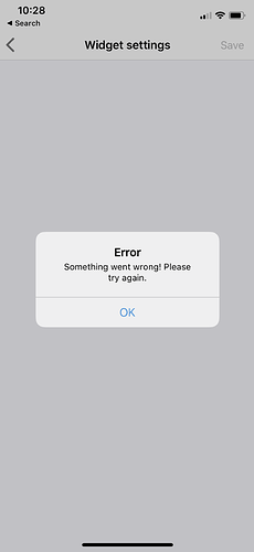

Since the classic app was no longer supported, I have been having issues with the new IOS app. When I access the app through cellular (wifi turned off, thus pihole not being used) the application works fine.
Here are the issues I am facing:
When trying to add a new device, “by device” or “By Brand”, the application returns with nothing listed
Smartapps do not function (all, but most of all Smart Lock Guest Access SmartApp", receive “Server error occurred” “Server isn’t responding” on home screen
As I stated, when I turn off Wifi, I have no issues with these functions
I have added the following sites to the Pi-Hole whitelist but the issues continue to exist
To try to find what other domains Smartthings are trying to call, I am monitoring the Pi-hole query log when I am accessing the app through Wifi and see no other domain denials to add to the whitelist.
Anyone have any idea how to resolve this? While I can get around turning off wifi when I add new devices, the SmartApp server problem makes any usage of Smartapps useless as long as I am on my wifi
In the past, it was basically the usage.trackjs.com url but for a few, SmartThings.com was needed. If you discover another domain needs to be whitelisted, report back for other users who might encounter the same issue.
I have added www.smartthings.com to the whitelist, but the problems persist. Is there other URL’s that Smartthings use, like when adding a new device when it needs to provide a list of brands?
Thanks, tried that and problem persists. This is especially frustrating because normally you would see the domain blocked in Pi-hole, then can whitelist it, but nothing appears to be blocked on the query list.
When I go to add a new smartapp, it comes back with “no items”. Another peculiarity is that when I disable Pi-hole, the problem persists, but works as long as I am off wifi. My Iphone has no firewall or filtering software on it. I have UFW running on the Raspberry PI that has Pi-hole installed, I have disabled UFW but that has not helped towards a resolution. So not sure what else could be impacting the ability for SmartThings to work correctly
