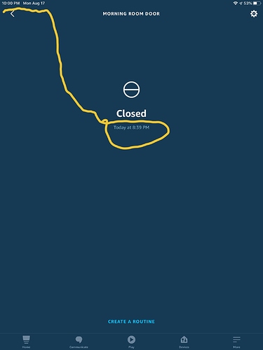

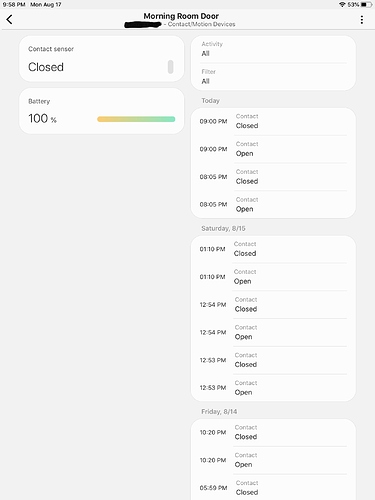

I set up a test routine on Alexa using my morning room door, (Aeotec recessed, Zwave), to trigger a notification when the door was opened. As you can see from the ST screenshot, I opened the door at exactly 9:00pm (open for about 10 seconds). My plan was to monitor the device on the Alexa app and see how long it took to reflect there. So, I checked it, and every 5 minutes closed the Alexa app on my iPad, reopened the app and checked the status/time. Again as you can see, it wasn’t changing…after an hour I gave up.
btw, the 8:39 time showing on the Alexa app was from the 8:05 open. Again, as of 10:00 the 9:00 open is not showing. So, based on JD’s comment It looks a lot like ITS A SMARTTHINGS PROBLEM!
