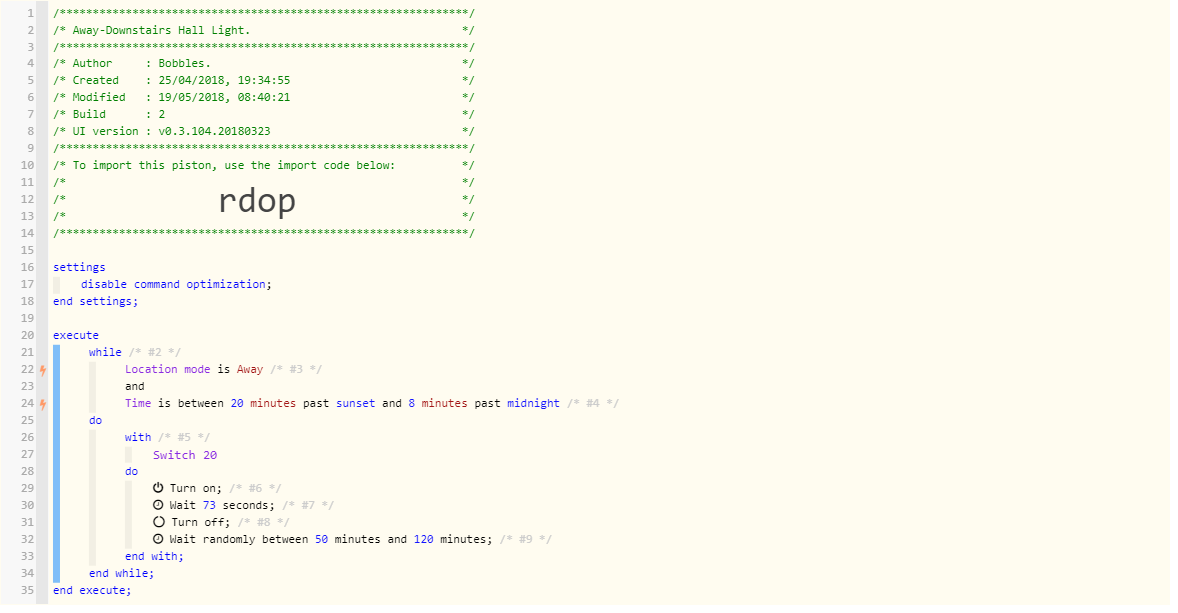

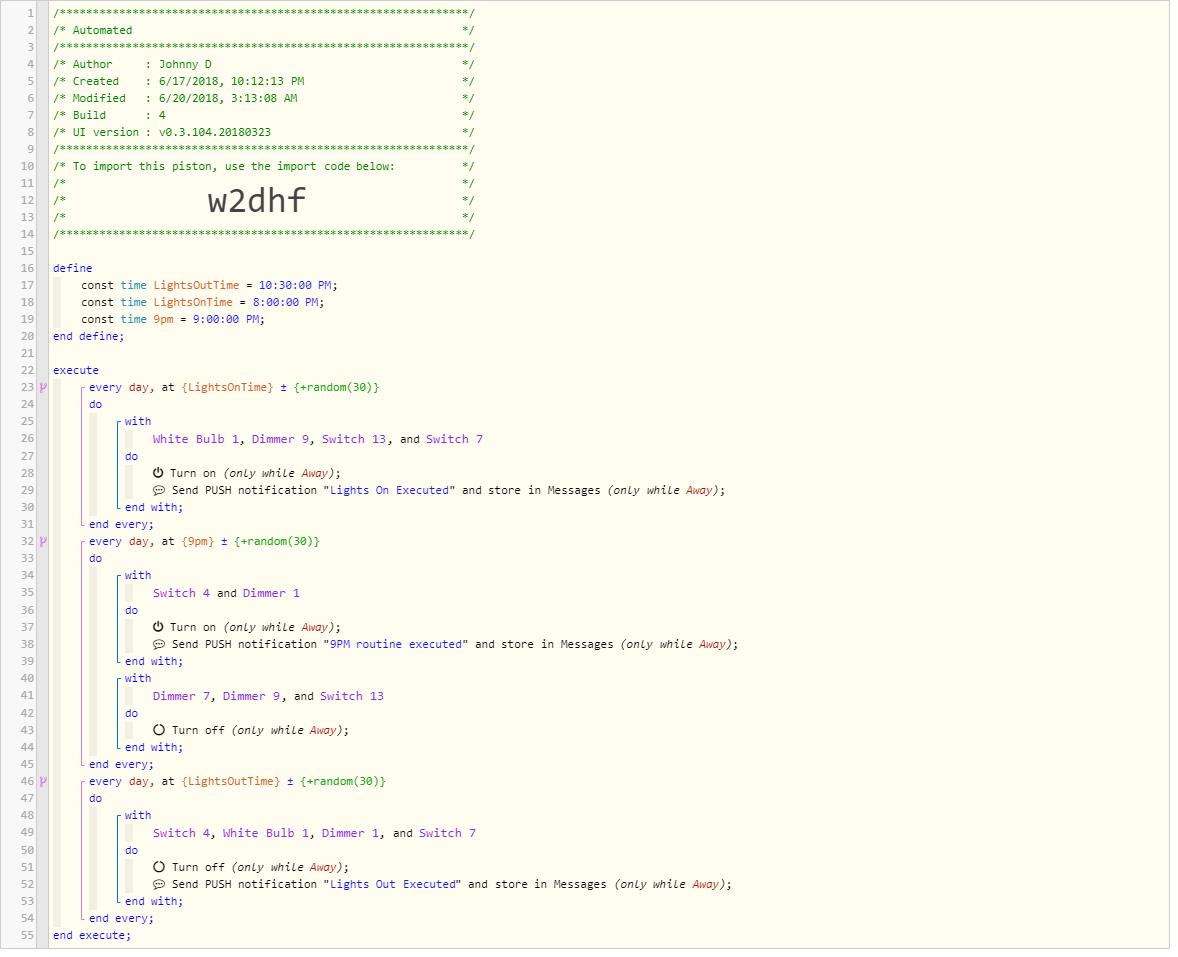

I used to use this but I found that the lights in my house aren’t really random. I used a WebCore script while I was on vacation recently and it worked well. Basically at X+random(30) turn on a set of light, at Y+random(30) turn on/off certain lights and at Z+random(30) turn off everything. Only do while Away mode.
I only have 2 lights that I do this for. The others (lounge, Kitchen, Dining Room etc.) turn on with Lux levels and turn off at random times to simulate us being at home and going to bed at different times on different days.

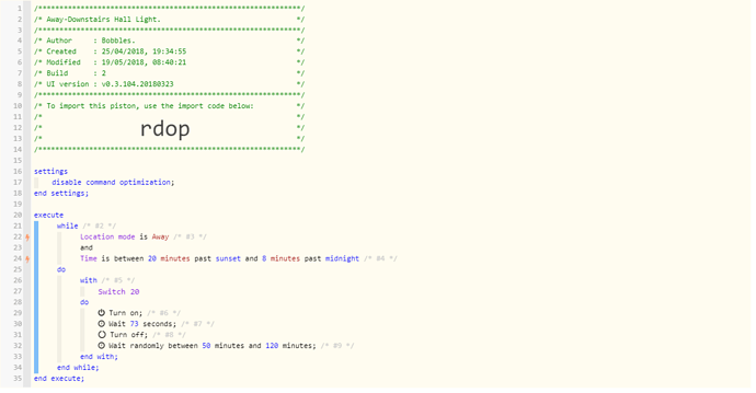

The lights I use this piston for are my downstairs (the one above) and upstairs hall lights.
I also have pistons that turn on my downstairs loo light if downstairs hall turns on (when we are away only) and is timed so it turns off before the hall light. This makes it look like I have gone to the downstairs loo by first turning on Hall light then loo light. Loo light turns off and then the hall light does.
