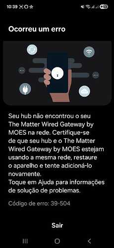

Hey guys, ever since the latest update, my Hub V3 has been extremely sluggish and freezing constantly, especially with Matter devices.

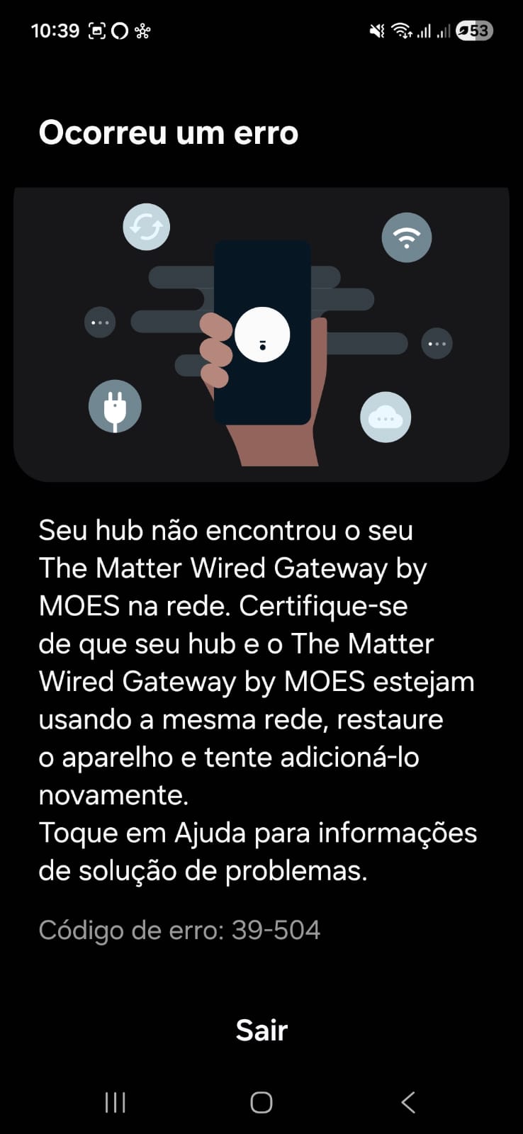

At first, I thought the issue was with my Tuya Matter hub, since most of my devices are Tuya and are bridged to the V3 through it. To test this, I even swapped the Tuya hub for a spare one I had on hand, but the behavior stayed exactly the same. On top of that, the devices are frequently going offline. Another important point is that during the hub swap, I had a hard time pairing another device, as it threw the same error multiple times. See attached screenshot.
Routines and scenes are lagging and taking a long time to trigger. Since most of these delays happen with devices coming from Tuya via Matter, I’m leaning toward the V3 being the main culprit after this firmware update.

Good morning! The issue only occurs with Matter devices brought over to the SmartThings (ST) hub via the Moes Matter hub. All scenes involving these bridged devices are failing. Additionally, I am also experiencing connection drops with Matter devices from other brands, but those are connected via Wi-Fi.
Bom dia! O problema ocorre somente com os dispositivos Matter integrados ao hub SmartThings (ST) por meio da ponte (bridge/gateway) da Moes. Todas as cenas que envolvem esses dispositivos replicados estão apresentando falhas. Além disso, também tenho perda de conexão com dispositivos Matter de outras marcas, porém estes estão conectados via Wi-Fi.
