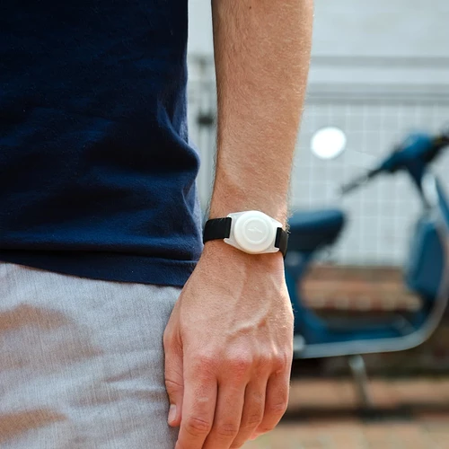

If you’re looking for either a USB plug-in IBeacon or you are OK with the battery powered IBeacon where you can’t replace the battery, then radius networks is a well-known reliable manufacturer. You can find their products at Amazon or on their own site. They even have a wearable with a wristband. :sunglasses: I have used some of theirs in the past and liked everything except the fact that the battery is not replaceable. They also have a USB plug-in model.
US Amazon:
The radius network platform is now called “flybuy“ so the following is the manufacturer site. Contact them for UK shipping.
