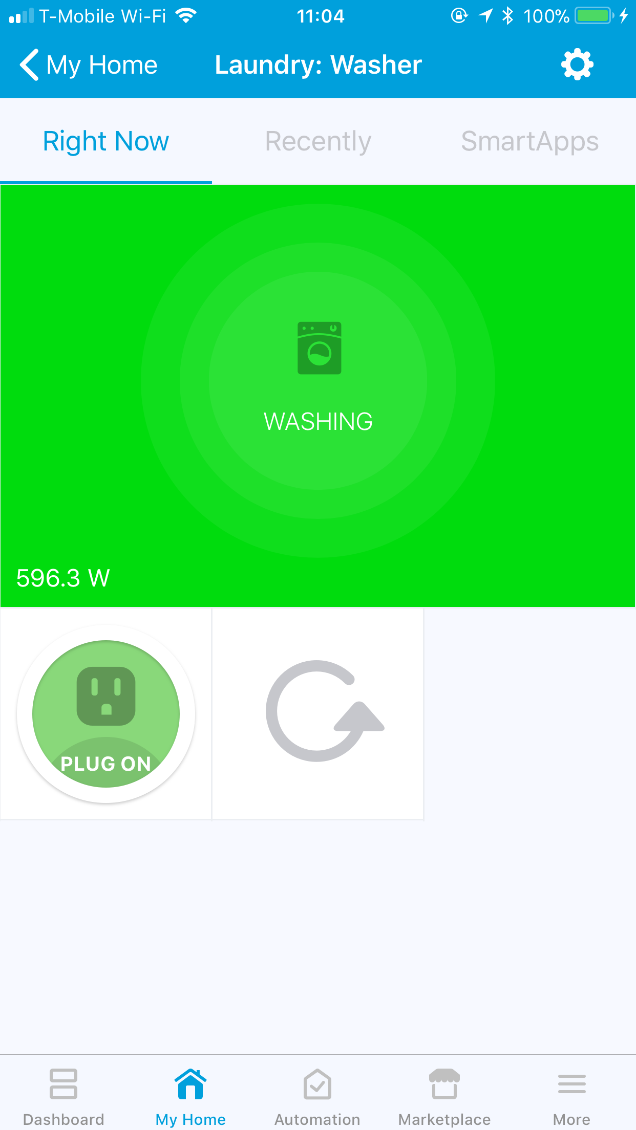

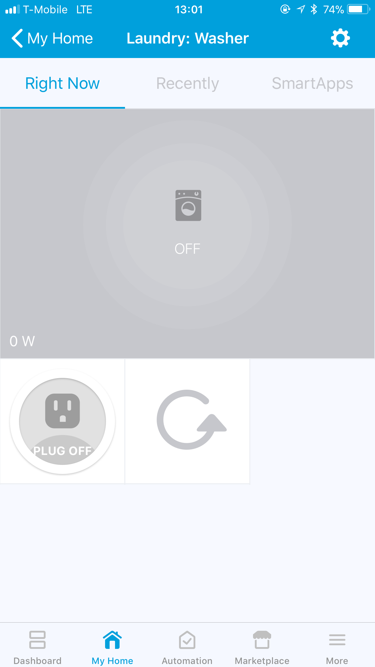

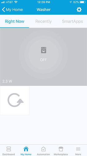

Some pics
The device handlers… Once installed change the trip point of the waher and dryer to a good value for your setup using the settings cog in the smartthings mobile app. I found sometimes my energy efficient washer will drop to no electrical load for a couple minutes at a time here and there which is why my webcore piston factors in some delays to start and send the notifications.

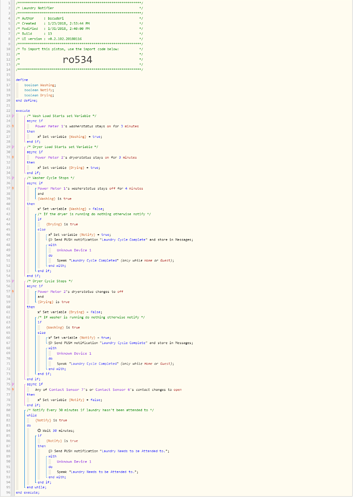

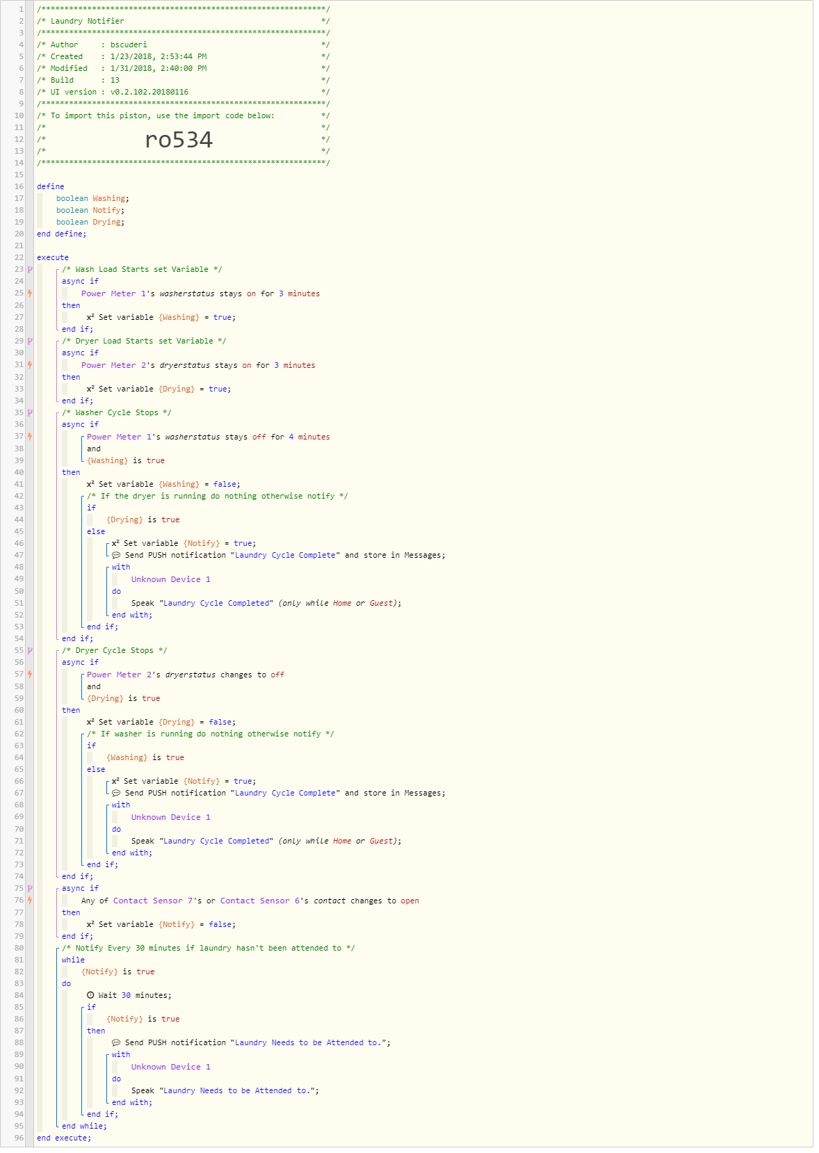

Webcore Piston
**edited this part cause I found an error. here’s the new one so it doesn’t keep notifying
