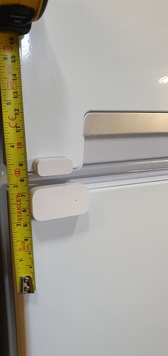

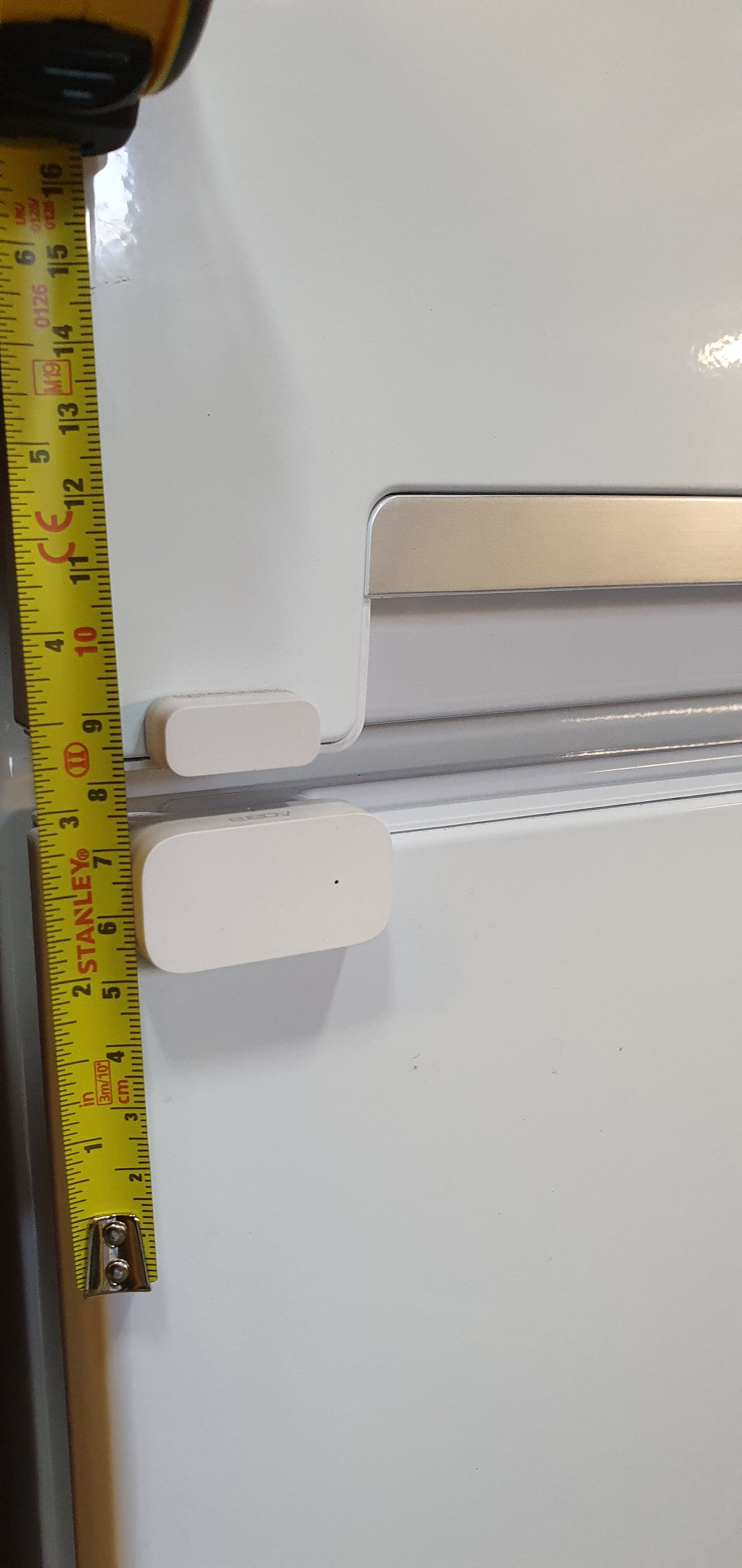

I just fitted a sensor on the freezer door, so my beer doesn’t get warm I found the smartthings multi purpose sensor doesnt work with such a big gap, so I tried an Aqara sensor which worked just fine with the big gap. But I then needed a smartthings smart plug in the garage to repeat the zigbee signal to the Aqara. The ikea plugs didn’t repeat to it, so i removed them from the garage and used them in the house instead. I then used webcore to alert me if the doors stay open for more that 5mins.
