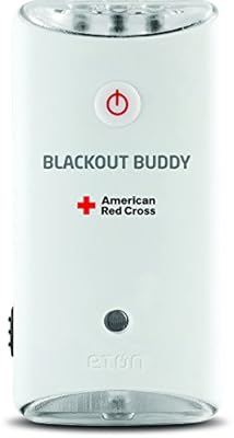

When I lived in a rural area with frequent power outages, most people just got a $10 power failure flashlight which plugs into a wall socket and lights up brightly if there’s a power failure. The point is you want to be awakened if the power goes off so you can deal with it (if nothing else, to call the power company). You take the light out of the socket and use it as a flashlight if needed. Although at our house we just also keep a stand up LED emergency light in each bedroom with a carry handle you can take from room to room.
Eton is the Red Cross recommended brand for the power failure notifier, but there are lots of others.

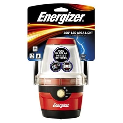

And this is the 96 lumens Energizer standup lantern we use for area light in a blackout, over 100 hours on D batteries.
So the Eton wakes us up when the power goes off and the Energizer is easily portable and provides wide area light.
If your fibaro isn’t going to light up until you move into its path, where are you going to position it? And are you just going to sleep through the outage unless you happen to wake up for some other reason?
With so many good standup flashlights available now, I don’t think I’d want to use UPS power to maintain motion detector lighting in an emergency, it seems like there are higher priority uses for emergency power. What am I missing?
