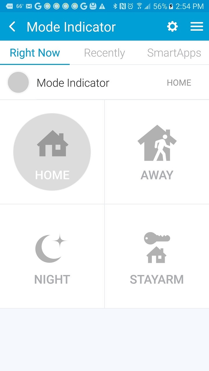

George, are you still out there? I tried using your code. I can see the mode change status if I change it via a piston or IDE but it’s not working the other way. When I click a mode nothing happens. No log, no error no mode change. I was wondering if you could help me out?
