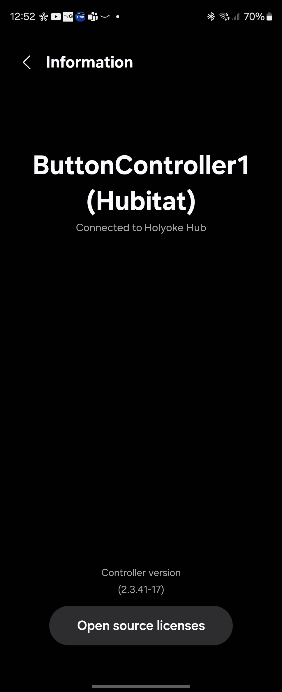

What virtual device is being used on the ST side? A screenshot may help too.
@csstup Hi Mate, any plan to bring battery capability from hubitat to ST
Looking at the history of the virtual device, I think I see the issue. Everytime I press a button, it’s also registering a press for the main button.
Except, that there isn’t a main button. There’s buttons 1-4, but the virtual device is showing a main button, plus buttons 1-4. There should only be buttons 1-4.
This is the device:
https://www.getzooz.com/zen37-wall-remote/
I think a temporary fix here is to remove the action I have for the main button, since there isn’t one.
No, this is by design and is in line with how the other ST drivers work, including the virtuals and stock multi-button devices.
The “main” button is an “is any button pressed”, and the 1-4 component devices are for the specific button.
The “main” button device is used as an overall state, and to show the status on the summary card. If it didn’t have an overall state device, which button should it show on the card? It can’t show all X (in your case 4).
