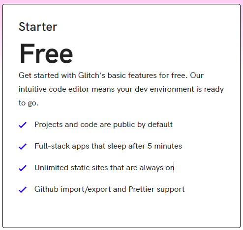

when you say it stops working, do you mean it doesn’t execute the commands after a while, or only that it’s not opening?
If you’re using Glitch, it’s possible it stops working because the free version has a sleep time, it’s the second point in this picture:

No, the Glitch project works fine and the App installs on the phone with the procedure in the tutorial. Well the tutorial is missing something because to make it work I have to enter a URL that Glitch complains about before the Developer Workspace and Glitch cooperate. I would have to do it again to document the step where tutorial leaves out a step.
The app worked OK on the iPhone, but a day or two later it stopped working with the popup error that says something went wrong. Do smartapps need a server to run on? Is that why the smartapp on my phone stops working. Because Glitch expired my smartapp on their machine?

Yes, they need a server to run. Glitch puts the server created for the SmartApp to sleep so, if you enter the Glitch URL of the project in a browser, it should wake it up.
