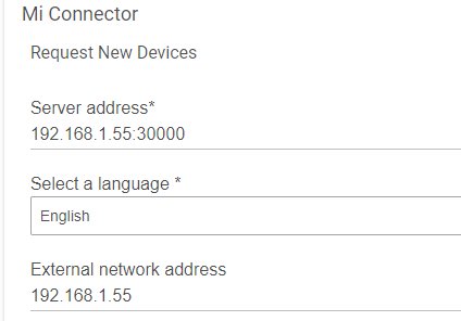

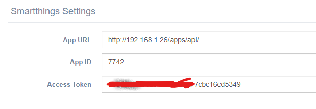

Thanks for your response. I can’t get HE to detect any of my devices activated in Mi Connector. In fact, I don’t think Mi Connector is linked to Hubitat and when I go to the settings of the management page, it only has smartthings settings (app url, app id and access token).
Royster
(Roy)
December 13, 2019, 2:28pm
806
Make sure the Mi Connector app code in HE has the OAuth enabled.
In the Mi Connector App in HE, you should have the settings for the Mi Connector docker (or rPI settings).
Hit the config button and obtain the details for what should be entered into the “smartthings” settings in Mi Connector docker.
In the MI Connector itself, you should have the settings for your HE app.
Then hit Register.

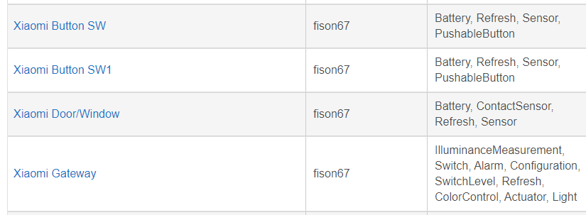

Make sure you have all the required drivers installed in HE for your devices.
Then on the Docker, if they have not been sent accross, you can do this manually.
Go to Add devices ST on the docker, and select a device where the radio button isnt greyed out.
Then hit Register. This should send the device to HE, check the list of devices in HE, and search for Xiaomi.
They should be listed.
