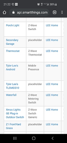

I have found the problem that has caused the automation to fail when based upon member location.
This new V1.7.51.42 causes a duplication of my phone in ‘My Devices’ when you check the IDE. One is listed as Mobile Presence and the other is a Placeholder. Go in and edit the device and change the display name so you can differentiate between the two when you get back to the app.
In the app, make sure you only select one when you are creating the automation. You will have to test which one works, as I have had conflicting results so far when switching between the two in the app. Suffice to say it will now work.
Don’t know why there is now a Placeholder for the mobile as well as Mobile Presence for the same device. Maybe this has something to do with the new ‘Find’ feature?

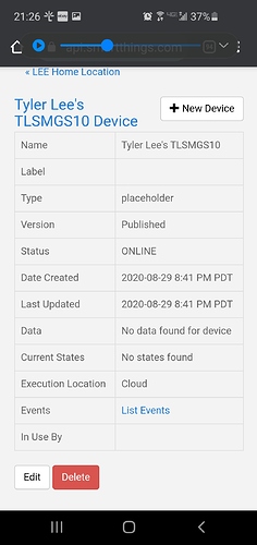

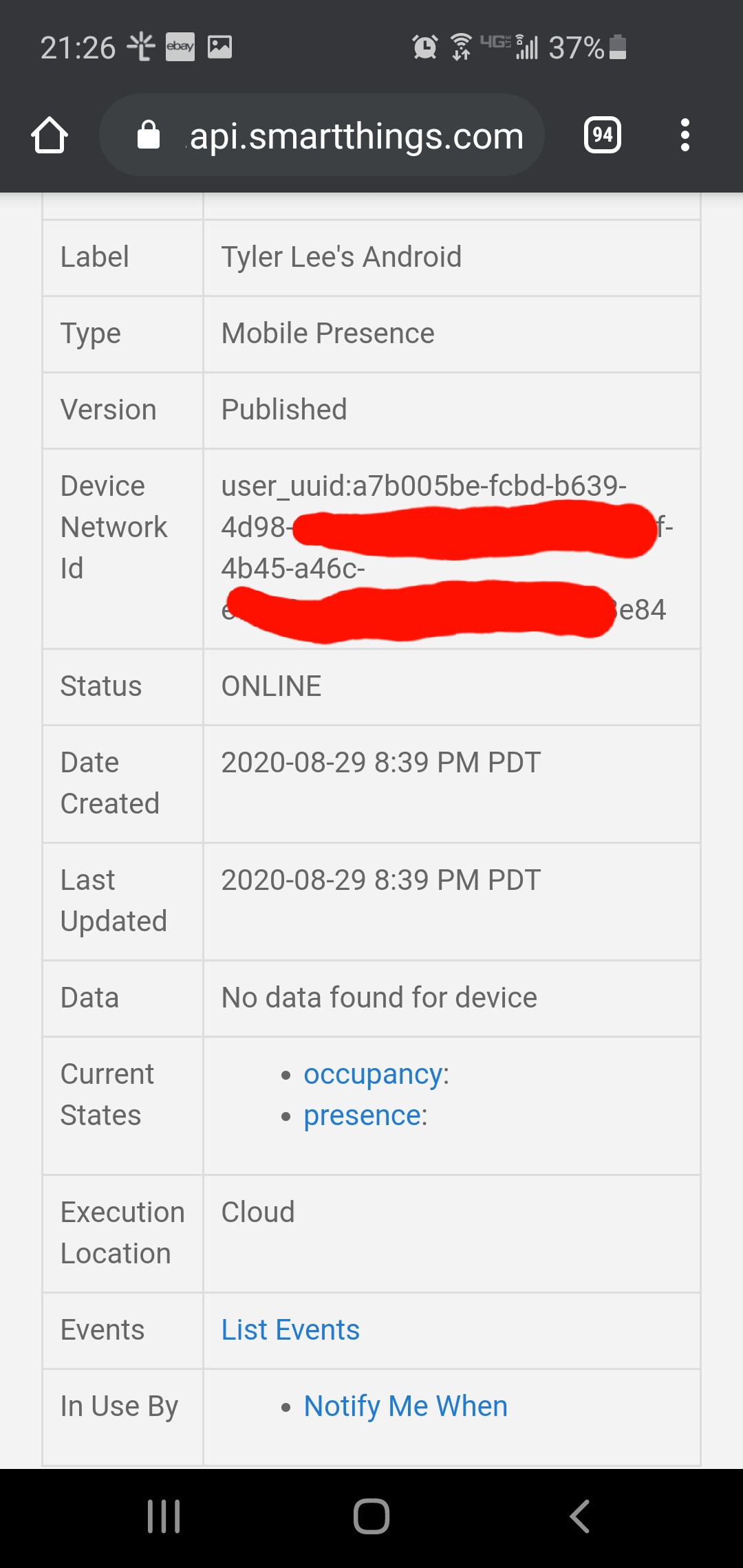

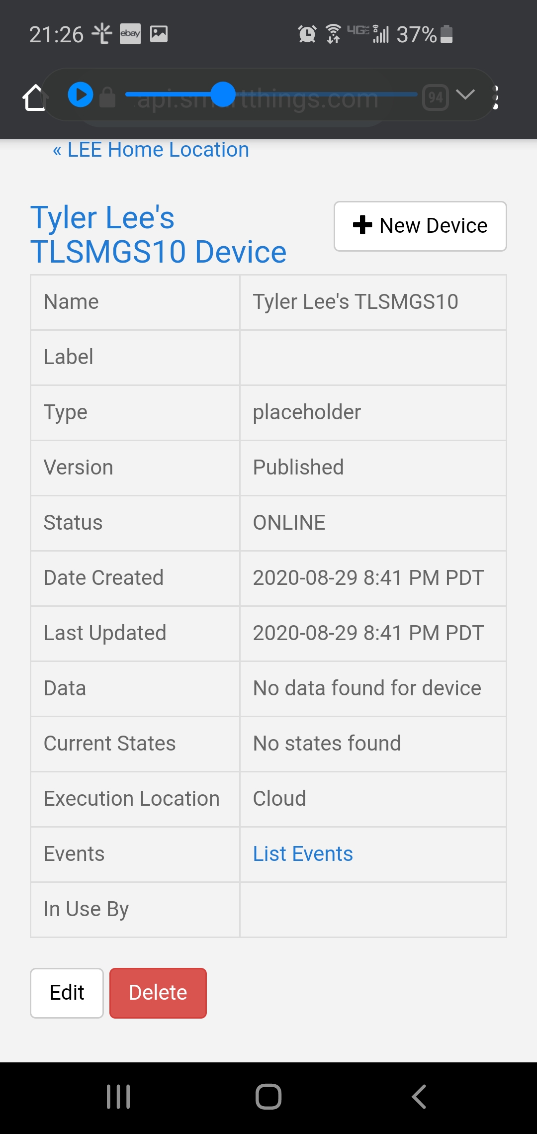

When i logged into IDE
I discovered this.
In Classic App when using your phone as presence it’s listed as Mobile Presence in IDE
In the NEW App when you utilize mobile presence it is listed as Placeholder.
What is Placeholder?
I selected my automations to run off Mobile Presence and did not include Placeholder if that makes any sense.
Running Mobile Presence from The New App (placeholder). Its doing weird things for instance. When I arrive home…it would acknowledge but then immediately it would change my status to Going away/ Bye Bye
So I unchecked Placeholder…and selected Mobile Presence as my Automation. If that makes any sense.
Can someone educate me …why in the New App when selected to use your phone as presence…it sets it as Placeholder instead of stating Mobile Presence in the Type category?
Tyler Lee android (classic app)
Tyler Lee TLSMGS10 (NEW App)
Same phone one is registered on classic app for presence and the other on the new app
The above is what it looks like in IDE in Classic App setting for mobile presence
The above is what it looks like in IDE for the New App for using phone as mobile presence (placeholder)
Because its not the same kind of device. It supports not only home and not home but technically supports other locations too.
Its the new style of device using the new APIs and back end and as such, doesnt need or technically use Groovy on the back end. The placeholder you see there is exactly that, just a placeholder… Its the interface back into the Groovy IDE.

Now if I go to IDE it shows duplicate phones (different names): What i add using the Classic app are shown as presence sensors, and then it automatically created “new ones” like placeholders.

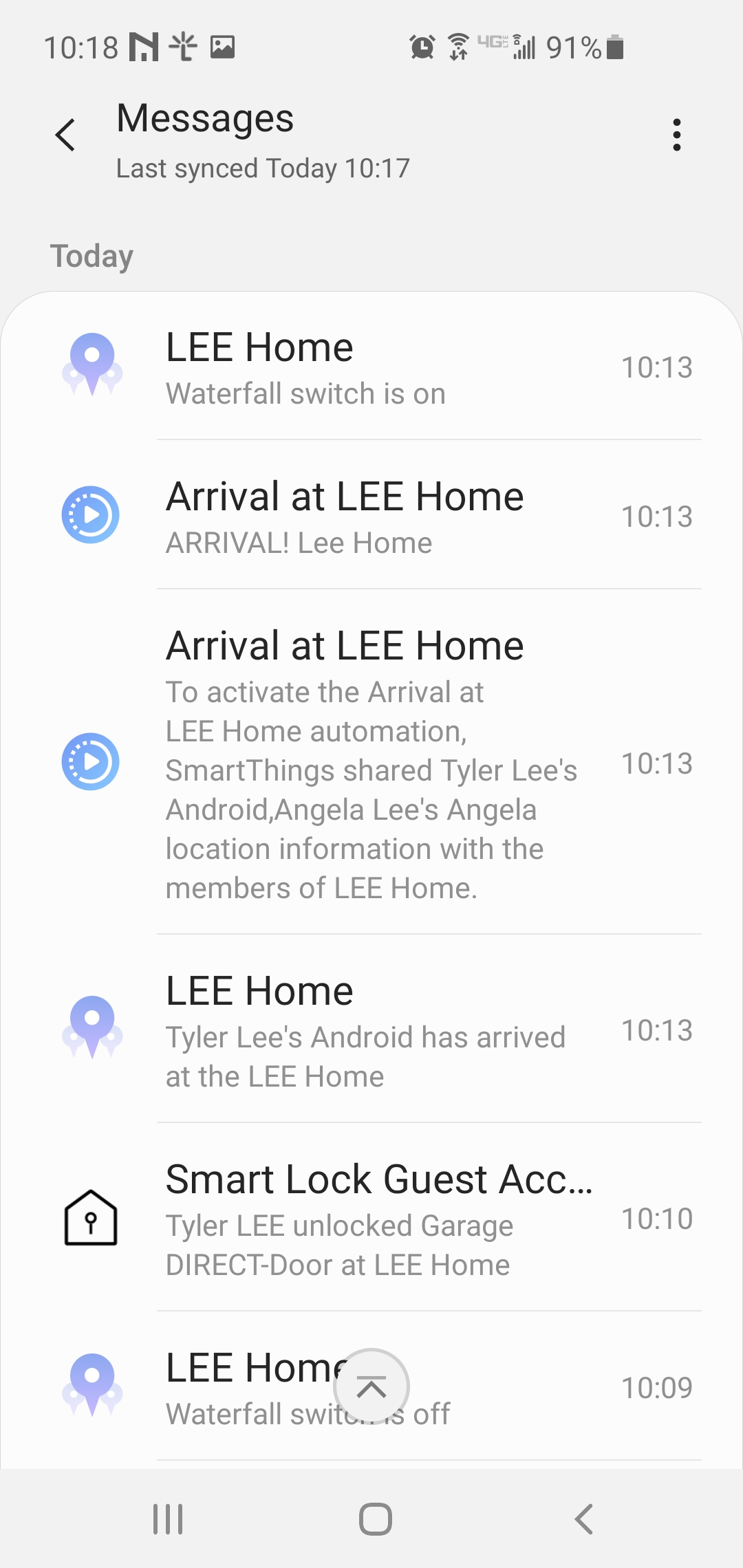

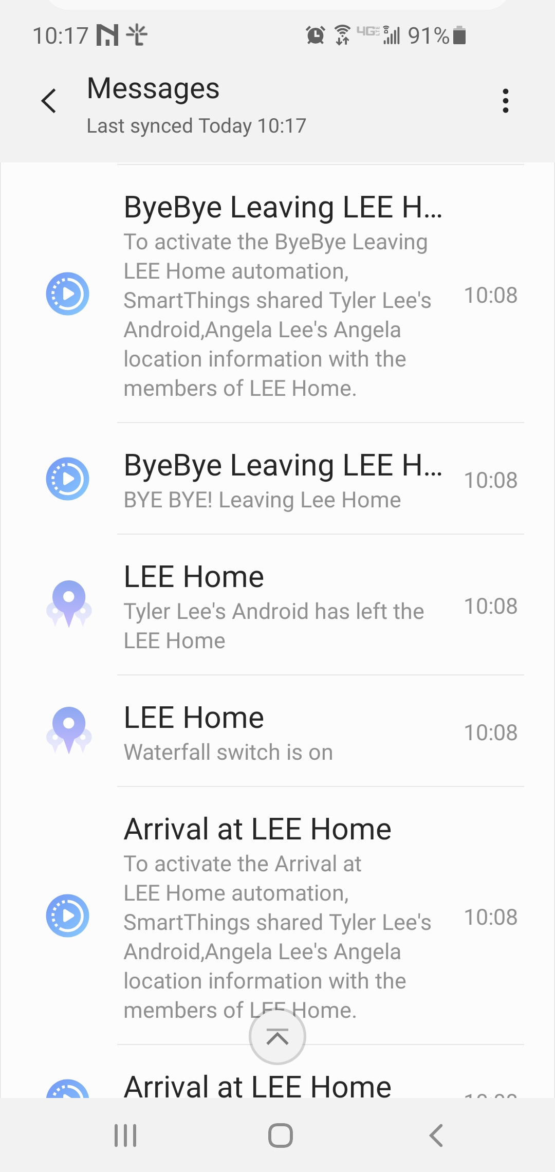

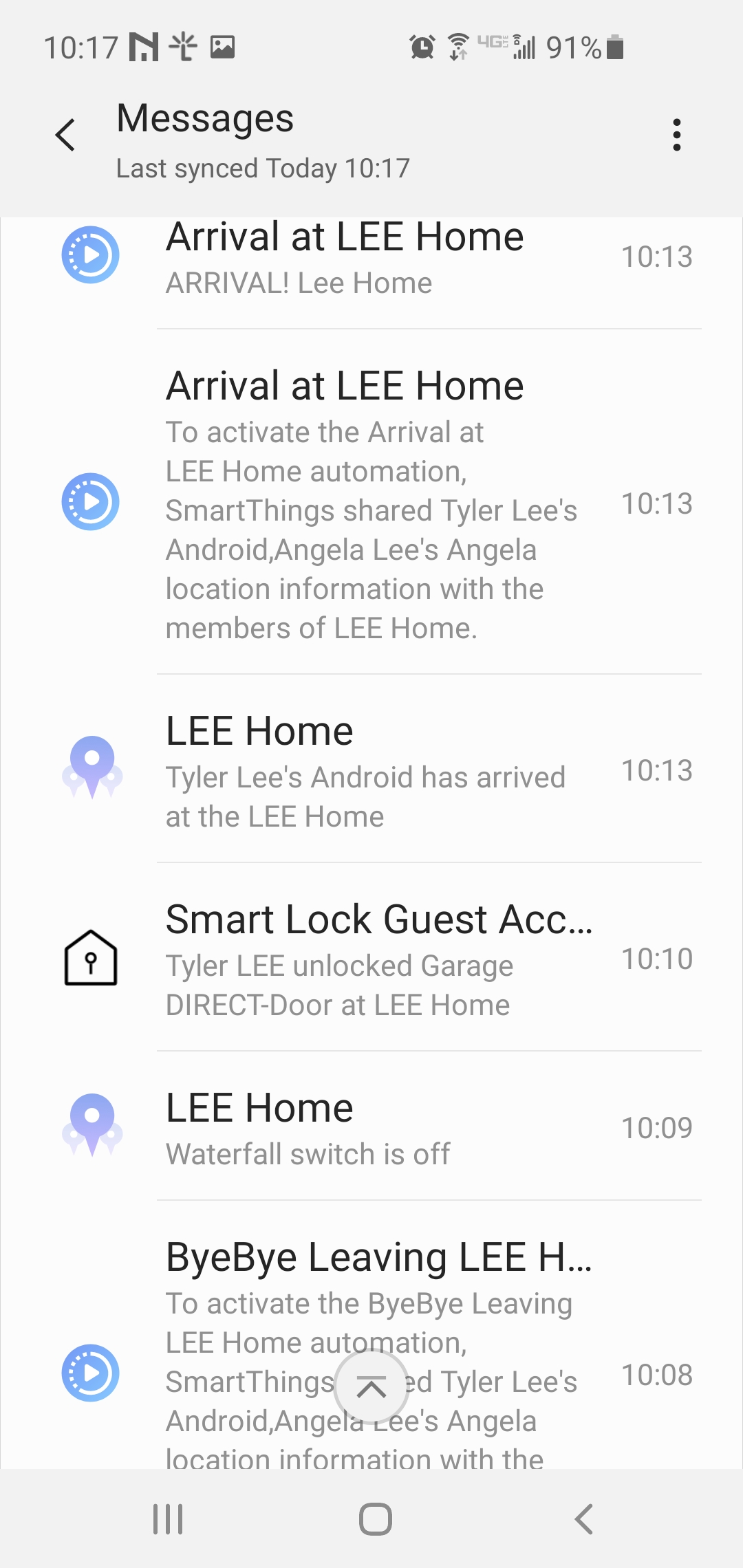

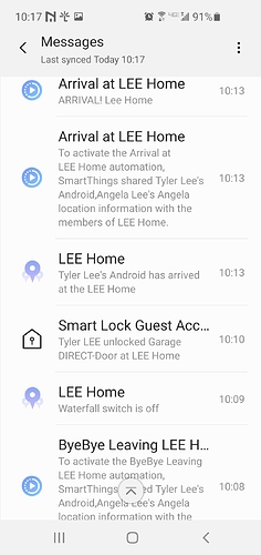

This presence bug has come back
I Arrive Home at 10:08 and within the same minute 10:08 it has me going Away Leaving
At 10:13 it has me Arriving/Home…and stays that way
What’s going ON?
I have the Mobile Presence (setting in classic app) set on the automations
The same thing occurs “if I had” the Presence setup in the Automations under the New App (placeholder).

*only happens to android platform
*ios platform it doesn’t do this
