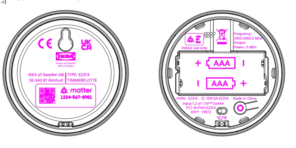

Read at reddit, thereâs an FCC certification for IKEAâs first Matter over Thread product, TIMMERFLOTTE temperature and humidity sensor.
That also means the DIRIGERA will finally get the Thread border router features enabled.
