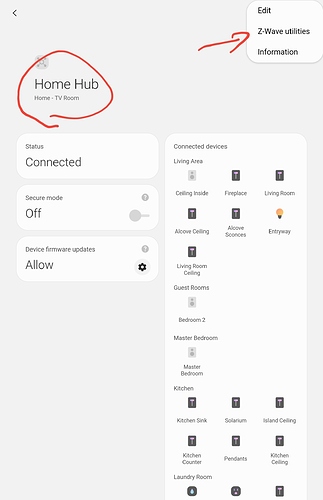

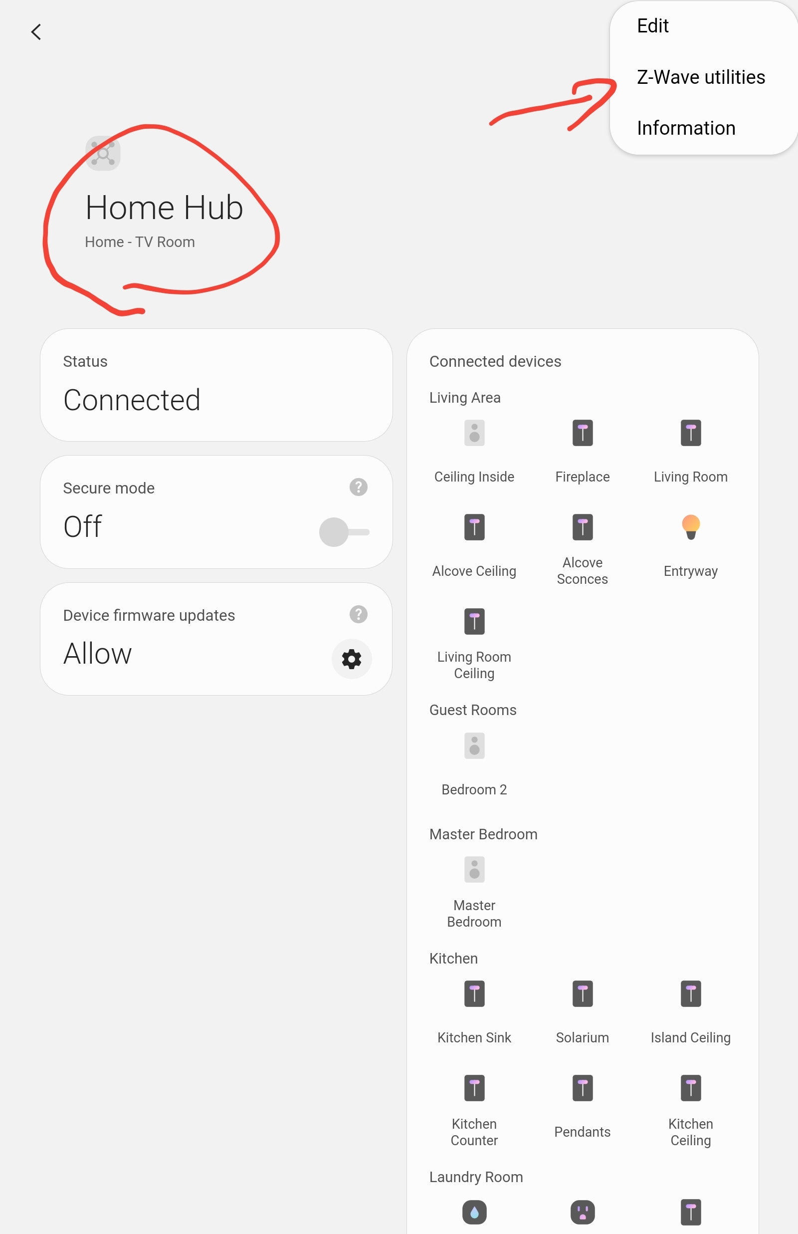

The icon for my smarthings app and the icon for this community are the same. The point in the instructions where I am having an issue is when I click on the three dots. It does not provide an option to select z-wave utilities. So I go to home then click on the three horizontal bars. Then i click on devices. Then I click on the three dots and I only get the option for Edit, Delete, or Sort by.
If you’re going down the General Exclusion path, labeled “Excluding a device that is not yet connected to SmartThings” in the instructions, are you selecting your SmartThings Hub as noted in step 2?
Once your hub details are displayed, then the three dots for the hub will have the Z-wave Utilities menu item.
It’s possible to have multiple hubs. The Z-wave operations have to be selected for a specific hub. So you only see that option once you’ve selected your hub.
