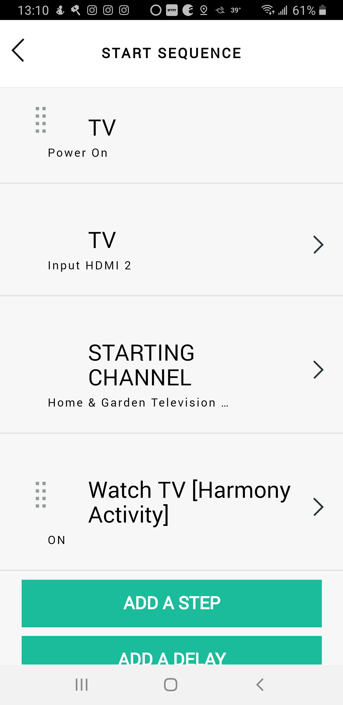

I think you slightly misunderstood. The trick is to expose the harmony activities switches from SmartThings and have the activity turn thise on immediately.
Here is what the start sequence for my watch tv activity looks like:
The last item is the SmartThings activity.
(Similar with the end activity seance to turn this off immediately.)
