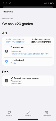

I have this:
IF temperature is below 20 celsius AND location mode is home
THEN
turn on the virtual switch for heating
This because I have a button next to my bed with
2 clicks bedtime everything goes off
1 click getting up for work
Hold is getting up not to go to work
However, the virtual switch is not activated if I hold the button and it is below 20. Can you not use the location as a trigger?

I push the button, the location goes from “night” to “home” (thuis in the picture) this automation checks if it is cold. When it is, am I in “home”? and then start the heating switch.

I may have found out why it doesn’t run properly.
As Nest keeps switching from Fahrenheit to Celsius and back and so on, my routine doesn’t add up.
It thinks it only has to start when it goes below 19 Fahrenheit but ofcourse it is celsius. So if Nest is displaying Fahrenheit, the routine doesn’t run!
Without changing anything but Nest reporting in Celsius:
