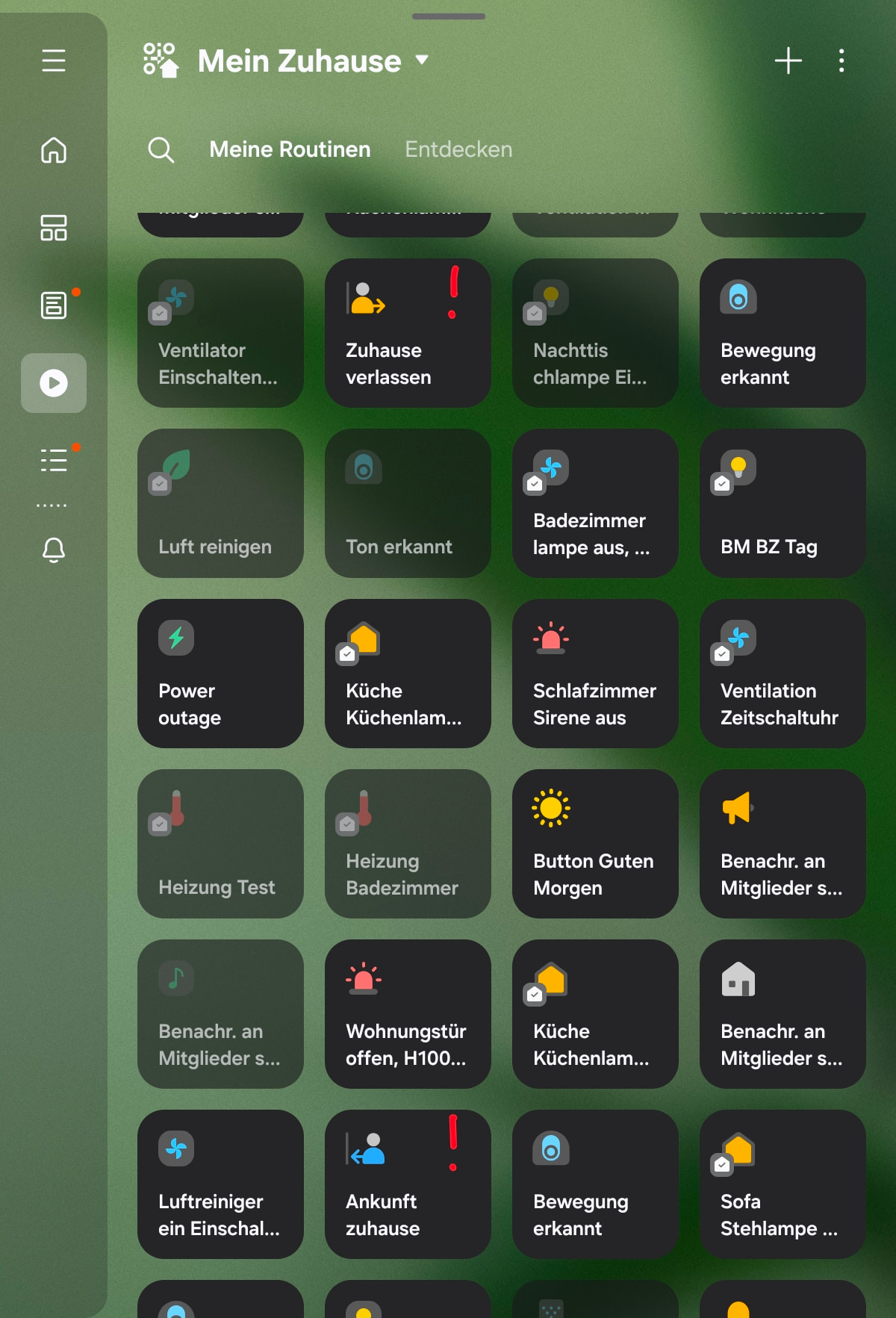

Also check your routines that use the member’s location and update those with the exclamation mark.
German, but you’ll get the idea:
I had to update them when I deleted and reinstalled the app.
