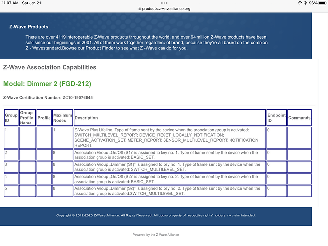

Each device is required by the independent third-party specifications to implement it exactly the same way. What they get to do differently is set parameters. And in the case of association they get to decide which group to use for which function, such as having separate groups for on/off binary switches and multilevel (dimmable) devices.
But even then, they are required to publish the parameters they will use with their conformance statement in the official Z wave alliance product catalog:
https://products.z-wavealliance.org/
The Z wave specification is published by the Z wave alliance, if that’s what you’re looking for. :thinking:
