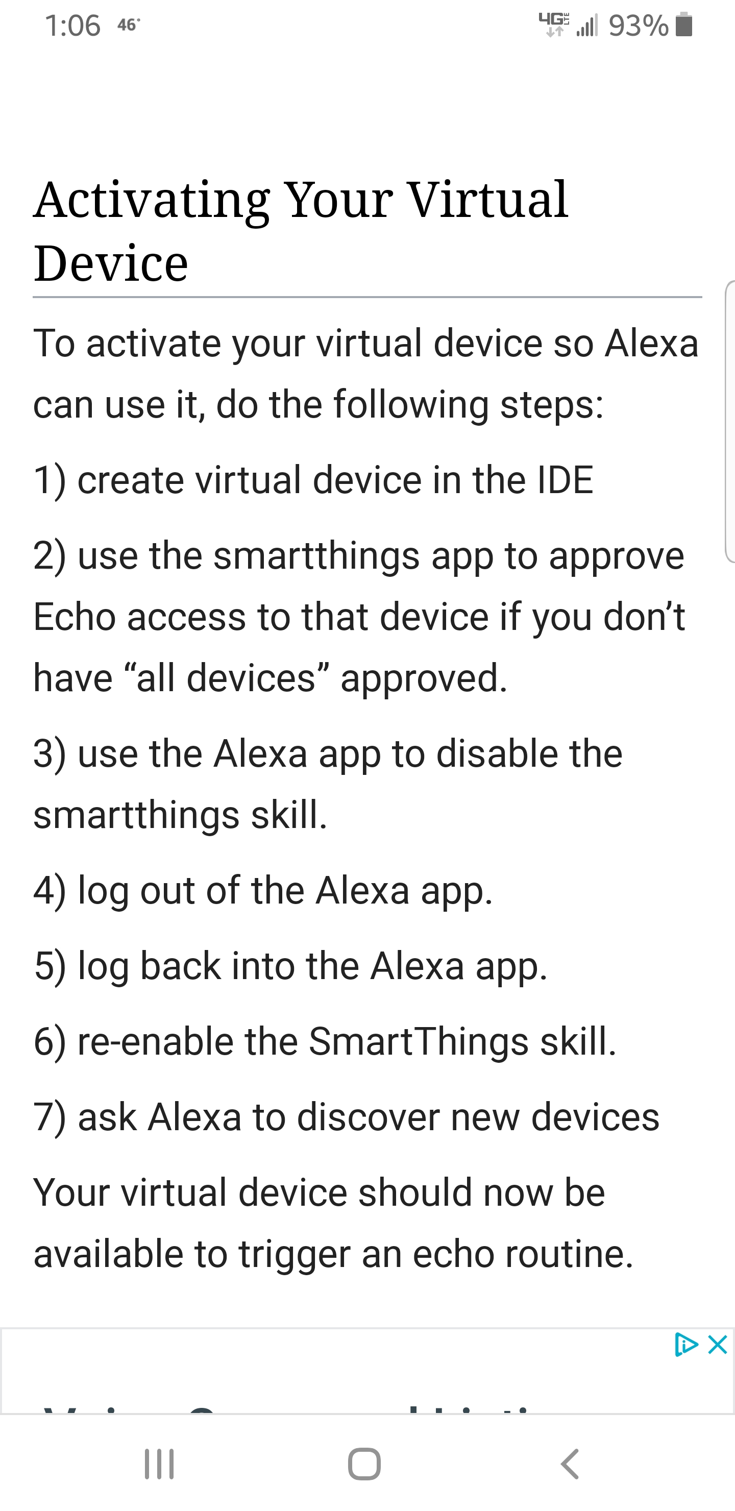

A work around if no one else has anything better… Create a virtual switch that when turned on, turns on the strip, discover that in Alexa, and that’ll at least give you voice control to turn on and off.
I have had similar problems with other devices. Just my thoughts here…
I have the Amazon Alexa smartapp installed in my SmartThings app (classic) (on my phone). Open that Amazon Alexa app and add your device - probably under “Switches”. Since your device is present in ST, it should be available to select and add to the Alexa app. Save that. Then tell Alexa to discover devices again.
Hmm… I created a virtual switch to try this workaround, but Alexa does not discover it either - so maybe something else unrelated to the Lightify device is going on. I’ll check in with ST support to try to resolve.
(Also, I already had “all devices” chosen in the Alexa smartapp in ST.)
Yes, the Ligtify device (as well as my later virtual switch for workaround testing) does show up in the Alexa SmartApp within ST. But it (and later switch I created) fail to show up after running Alexa’s discovery. I’ve tried with both the “select all device” option in the Alexa SmartApp, as well as independently selecting (all) devices – neither works.
