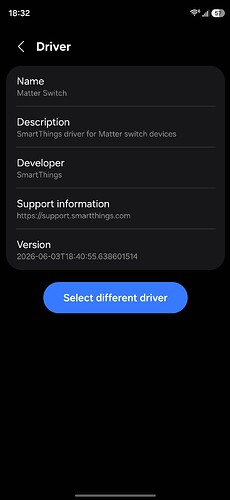

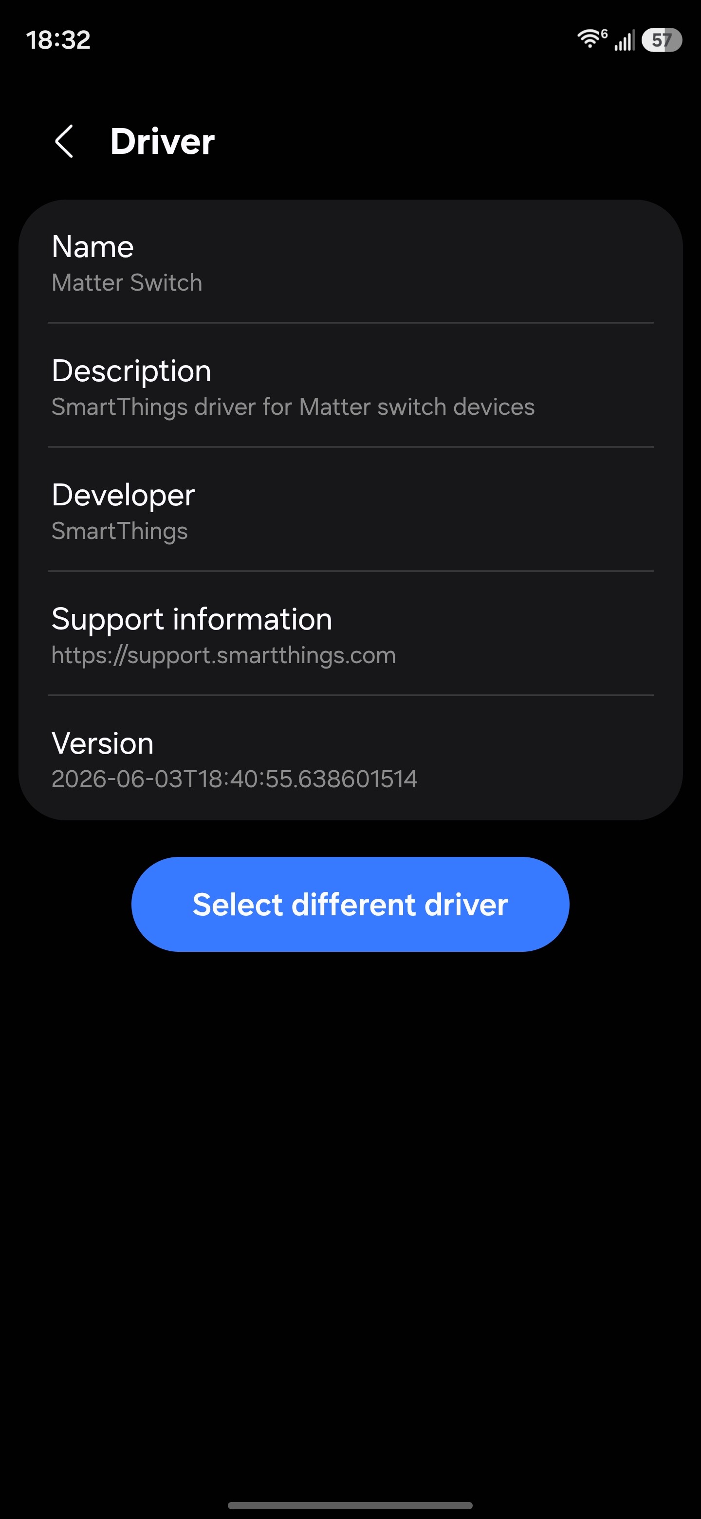

  • Switch the driver from within the SmartThings app: three dots → driver → Select different driver
