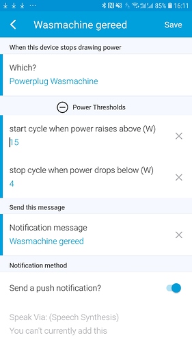

Don’t know if it’s the same app:

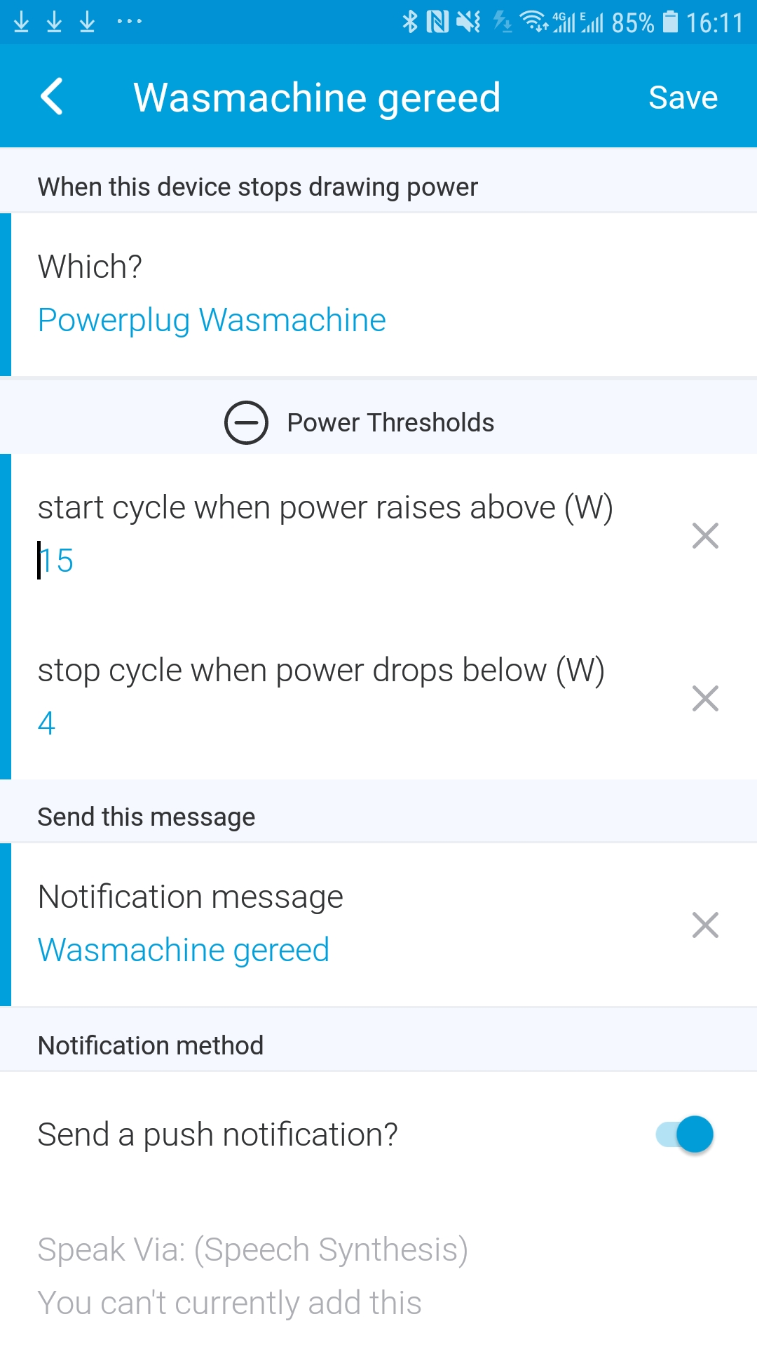

15 (Watt) for start/on/above and 4 (Watt) for stop/off/below.
I measure the power with a powerplug (Neo CoolCam zwave).
There are a few versions of this out in the wild. Like @benerkens said, is hard to know which one you have installed. Can you post a screenshot?
Here’s some screenshots you requested.
I also put a copy some of the log how the power rating.

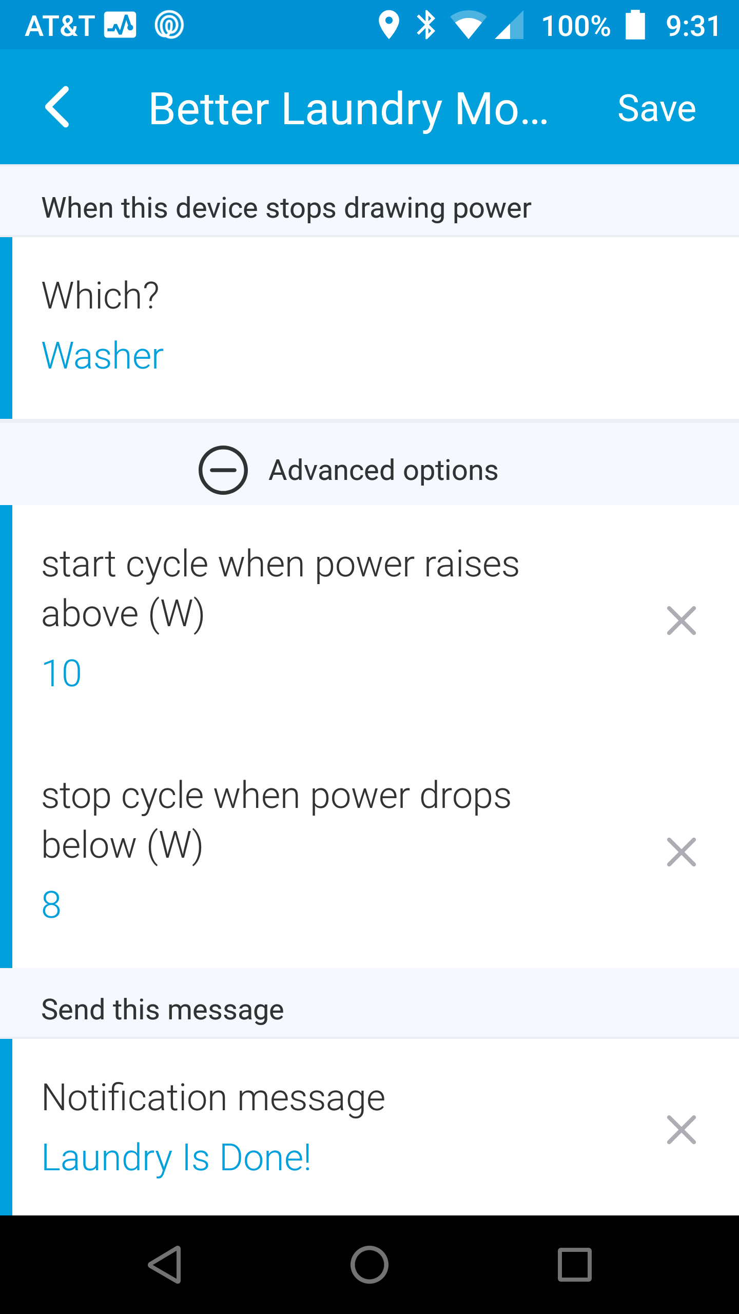

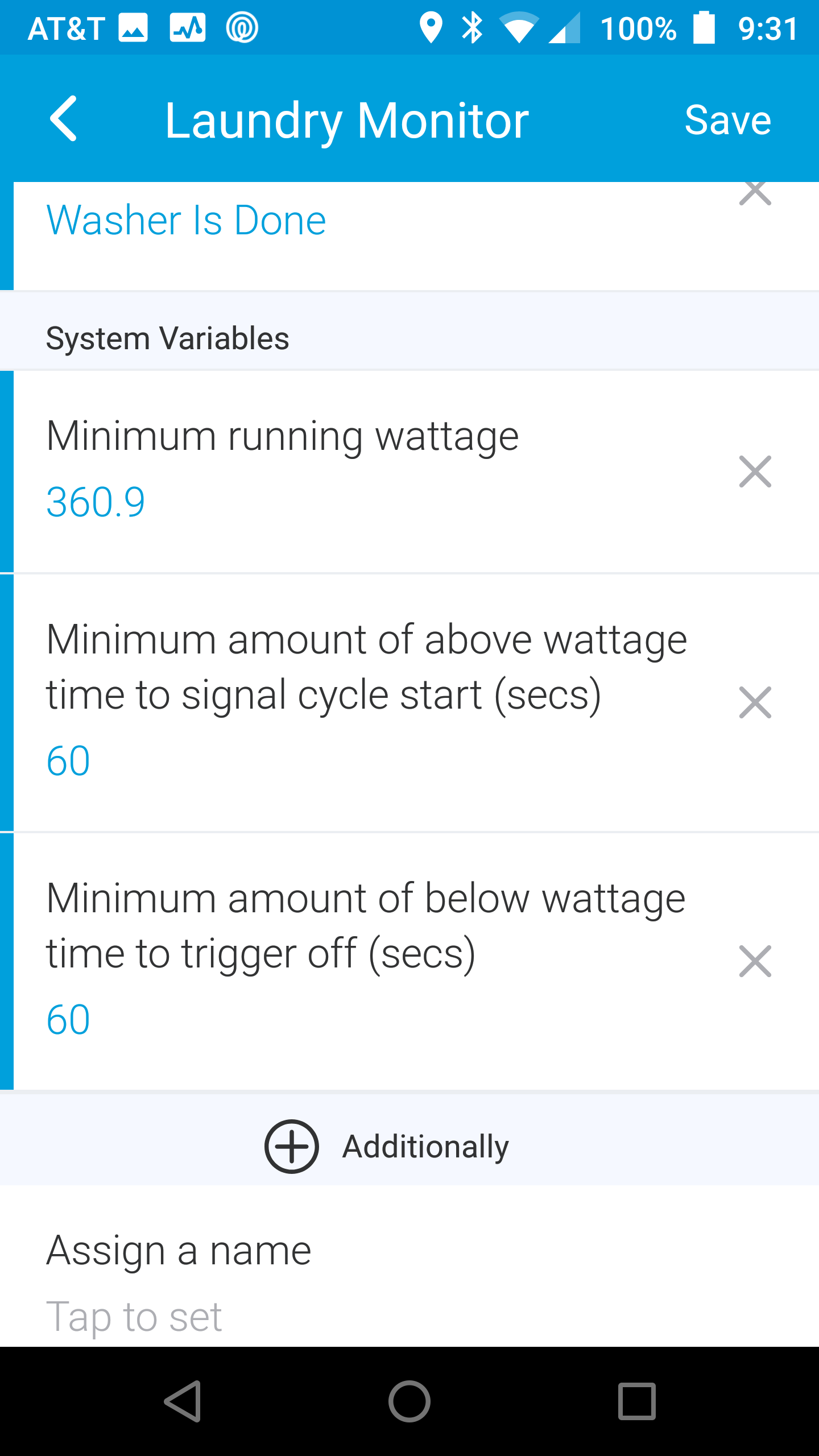

Ok, the numbers depend on your washer. Unfortunately you will need to observe the cycle and possibly adjust it over a few runs. My washer, for example drops below 3W for about 3 minutes during the normal cycle, so I have it as:
Cycle starts at over 10W
Cycle stops below 3W
Minimum amount below wattage = 5 minutes *
  • It never drops below 3W for more than 5 minutes unless the cycle stopped.

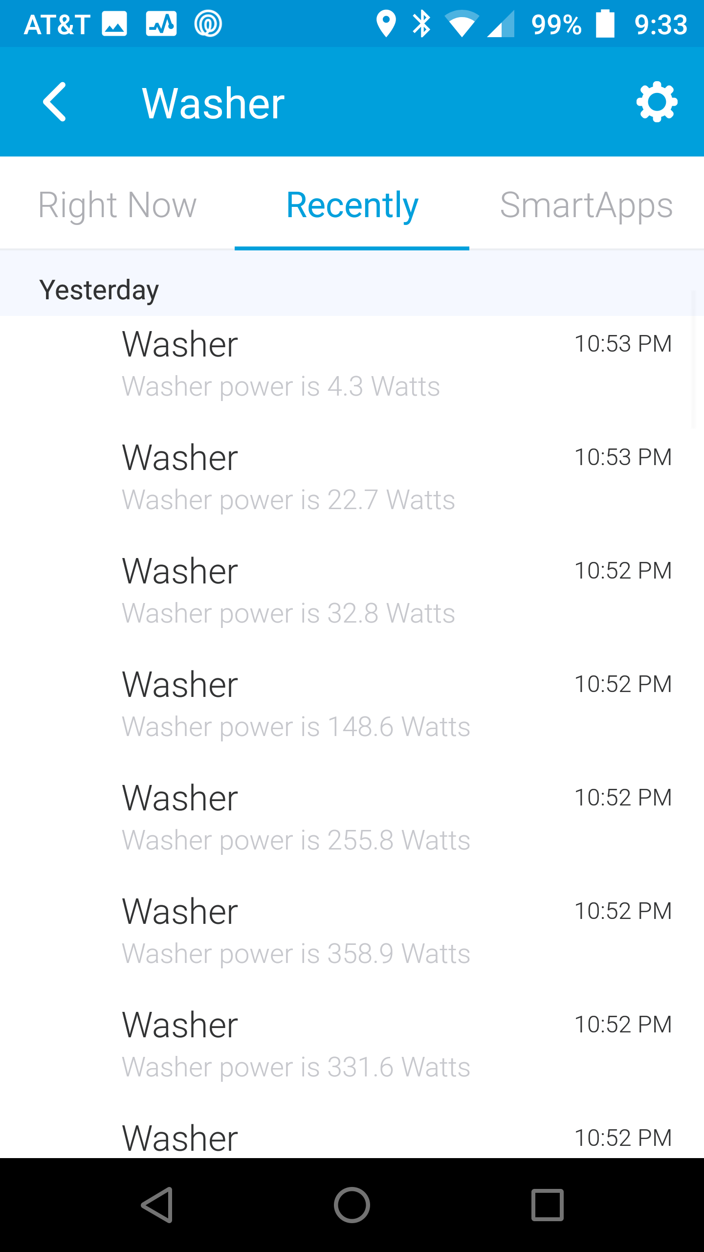

I will post the logs next time I do another load of laundry if you guys can help me I would appreciate it. I’m not good at this stuff
In your screenshot, last entry was at 4.3 W, what happened after that? Did it go up again or stayed the same?

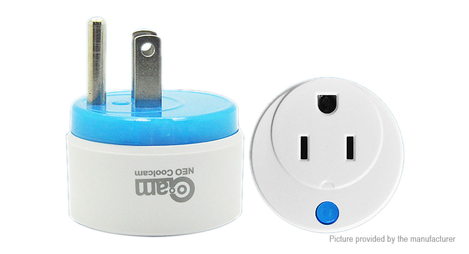

I use the “Better Laundry Monitor” with a Neo CoolCam Z-wave power plug.
One for the washing machine and one for the dryer.

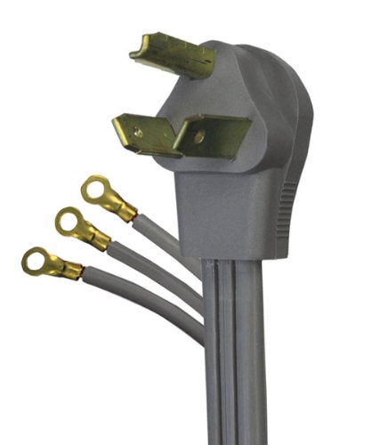

I don’t know the form of my outlets but I live in the u.s. my dryer uses 220 or 240
On AliExpress the specs say 110-220V, 50-60Hz, 13 Amp.
This is the US version
Neo CoolCam power plug US
but not a 220 or 240 v Plug.
240v

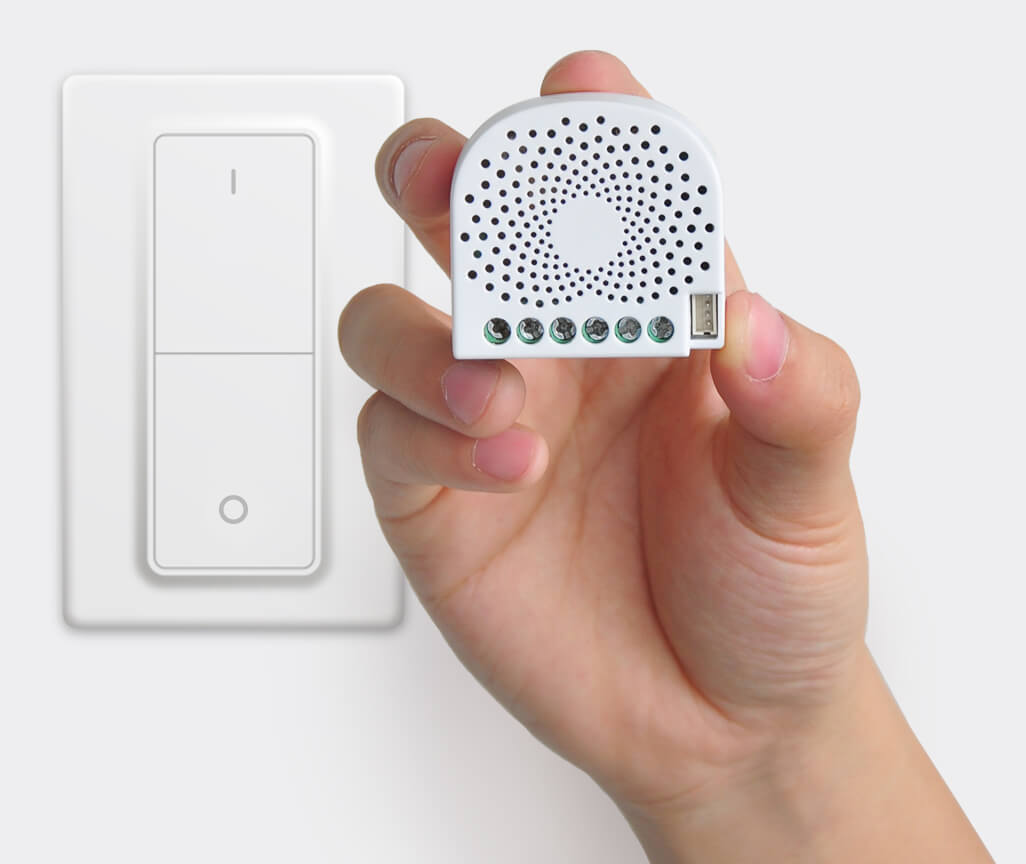

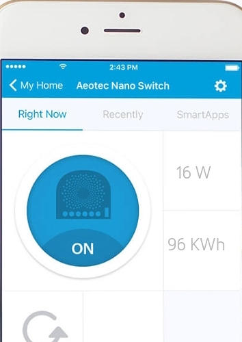

Can you install a switch module behind your power outlet in the wall box or in the mains that goes to the washing machine? It is a small module.
It is controlled by Z-Wave, you can switch on/off if you want (ie leak detection) and it measures voltage and current to calculate power consumption.
Aeotec switch module

In your dryer, can you install the Z-Wave switch module in their?
Op de rear where the mains cable comes from the wall outlet into the dryer, are you familiar to repair a dryer, replace a belt? Or know an electrician who can install the module for you?
