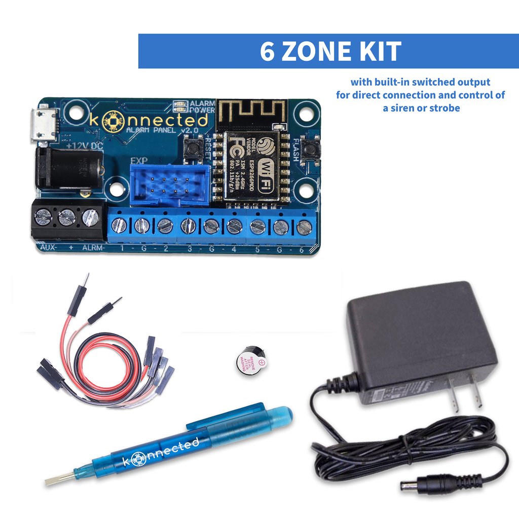

You will need our interface kit. Size depends on how many wired zones you have. Start with 6zones and can always expand later.

Yes, we have packaged our kits into two types now: Conversion Kit and Interface Kit
The latter includes the Interface module, which is needed to connect in-parallel to a traditional wired security panel. Both can be purchased from the main product page, here:
@ChelseaNick25 The kit contains everything you need for a successful installation. If you want to do the keypad -> tablet conversion also, then you should pick up a 12V to 5V USB Converter with the right connector tip for your tablet .
