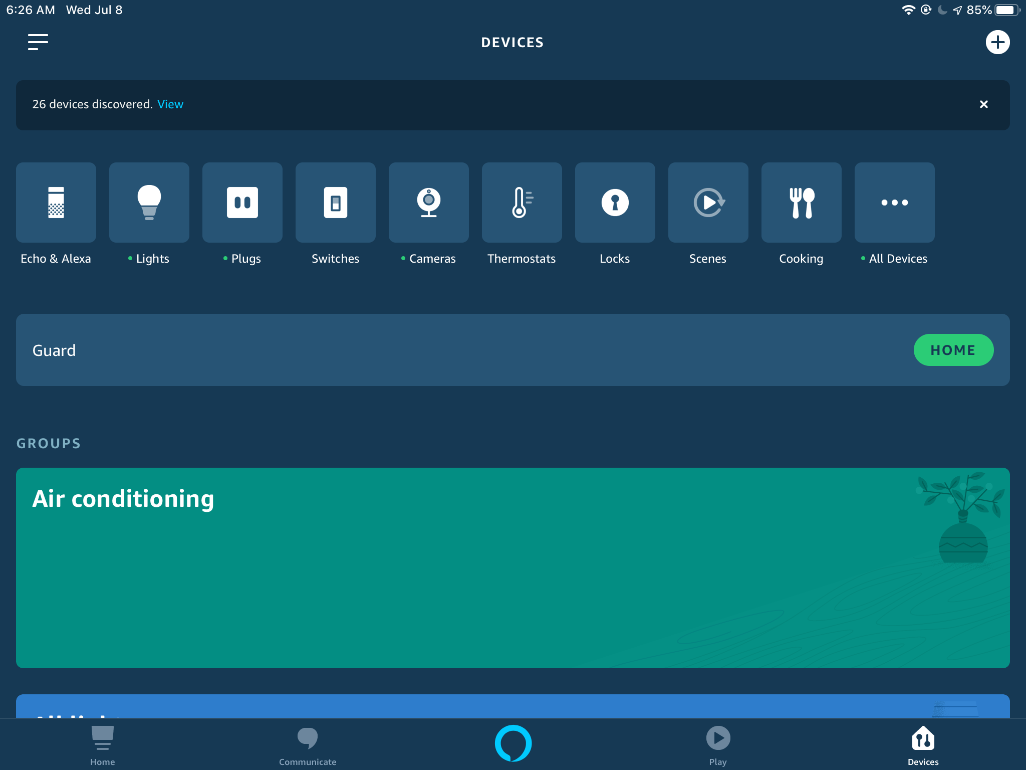

There’s a big difference for people who use Amazon Echo. If you say “Alexa, turn off the lights,” that will turn off the bulbs and switches in the room, but not the outlets.
But you can change that group designation through the Alexa app just for Alexa purposes if needed. :sunglasses:
