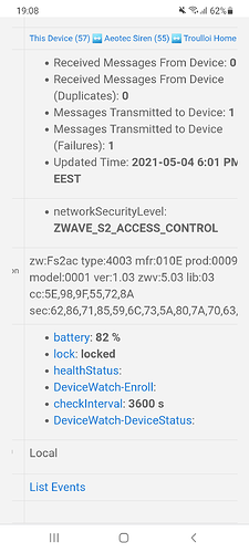

I have noticed in the IDE that the Danalock does not route through the Fibaro switches as it used to. I have no idea what to do at this point.

The funny thing was it was working! The only z-wave devices i have left working as repeaters are the 2 fibaro switches and an aeotec siren. One of the fibaros is right next to the door and gets routed through the other fibaro switch. I don’t think this is a signal strength issue, but rather a routing one…
Which model number is the Danalock? And the Fibaro nearest the lock? And when you check the IDE, which security level is each using? I’m just wondering if there might be a zwave security level issue.

No it does not seem to work now but it was working. Also i did try to remove the siren from the network and make a network repair and it does not change. I do believe however that it was connected via the fibaro switch. Maybe the last hub firmware is to blame for this.
So the danalock could be routed from the aeotec siren but as it is not s2, that is why it is not working? Also if so why doesn’t it try to route through the fibaros?
