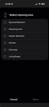

Hey everyone, just jumping in to share some updates from my side.
I’ve created a Roborock Matter plugin, and it works well with Samsung SmartThings.
It’s based on the matterbridge project, so if you’re looking to integrate your vacuum with SmartThings without relying on IFTTT, Alexa, etc., this might be a good option.
Right now, I’m working on adding room cleaning support.
If anyone’s interested in testing or collaborating, feel free to reach out!

Hi, sorry for the late response
It should be as easy as install the GitHub - Luligu/matterbridge: Matterbridge plugin manager for Matter
npm install -g matterbridge --omit=dev
and in the interface, search for
matterbridge-miio-roborock
After installation, I recommend restarting Matterbridge. Then, you can enter your device token in the settings and restart again.
After you have the basic functions working, you can set up the room names in the settings.
Please let me know if I’m missing something or if you have any questions
