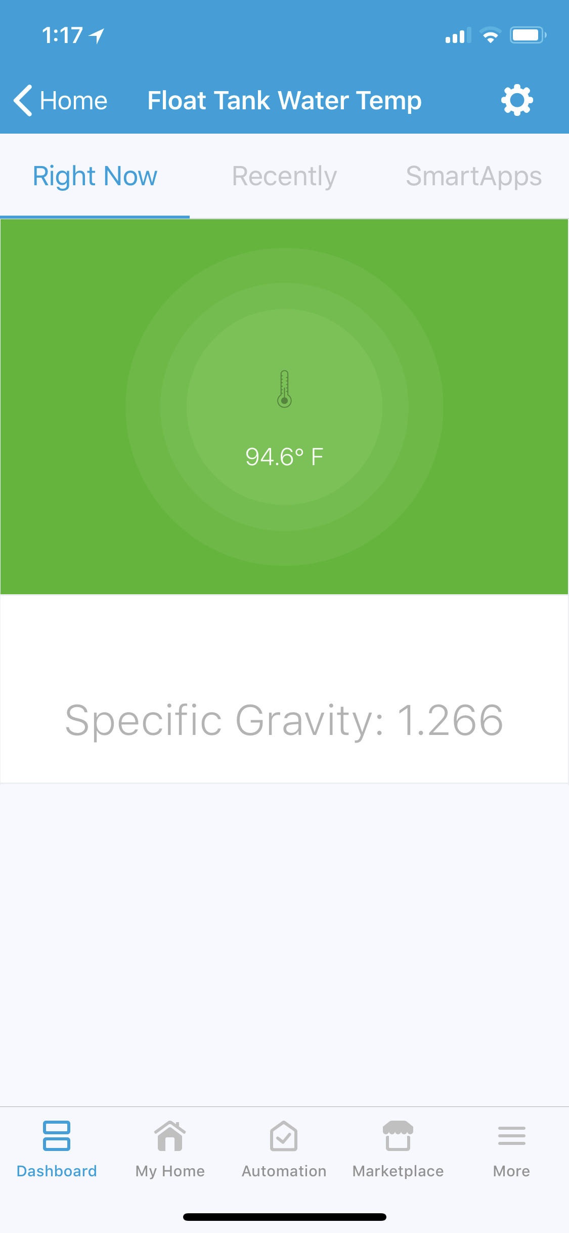

You can definitely modify your pool heater code to add in code to pull in your cost value. Look into adding a “value” tile to your pool heater to add in the extra data. The attached photo is how I used one device to display two data types.
Glad it worked out. Let me know if you run into any issues as most of my time figuring it out was spent trying to figure out the tiles.
One issue I ran into was that I need multiple decimal numbers, and smartthings wants to round to one decimal point.

You’re welcome. Here is the code I used to get the second tile:
    valueTile("specificGravity", "device.specificGravity", width: 6, height: 2) {
		state "specificGravity", label:'${currentValue}',
		icon: ""
Make sure you add second tile name to the “details” section of the tiles:
	details("mainTile", "specificGravity")
