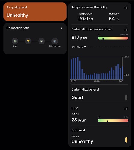

Edit: update successfully finished, but now I’m going to die:
Me too, and sooner than you :weary_face:
The list of supported values is still the same as before the update - even after switching the driver:
Unknown, good and unhealthy.
If you want, you could delete the device and add it back again to enforce a re-scan, @Declankh . I’m not at home right now.
Maybe , not tonight though :grin:
