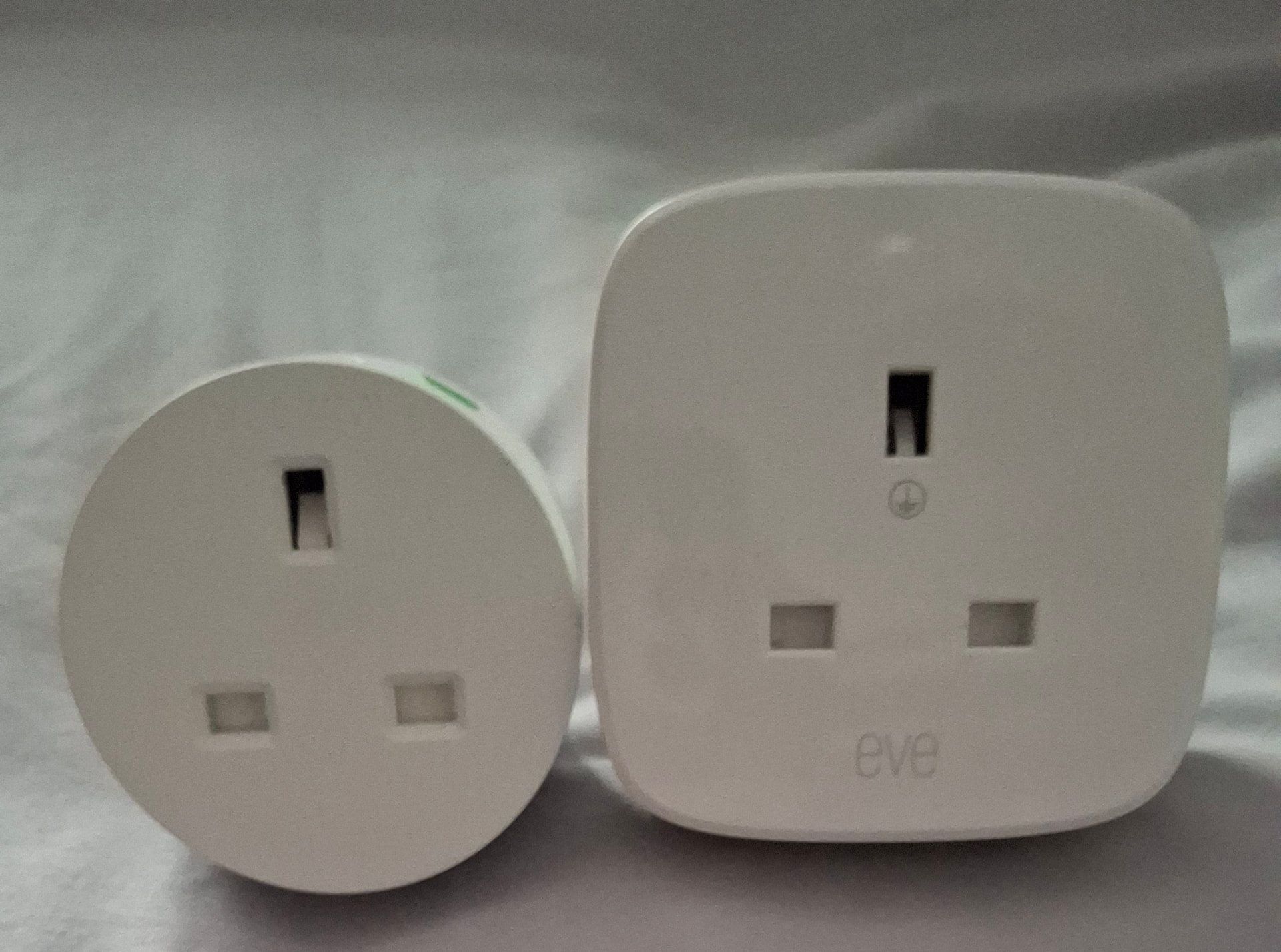

The UK 13 A mains plug is great. It is the Eve Energy that is massive. Here it is next to a Grillplats, which is itself pretty chunky, but no more so than an Onvis S4 Matter.
The UK Matter over Thread plugs are typically about one cm bigger all round than Matter over Wi-Fi or Zigbee plugs.
IKEA and Eve have at least put the button on the top, which is more than Meross or Onvis have managed.
