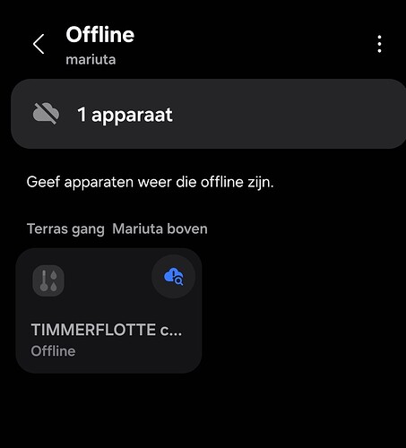

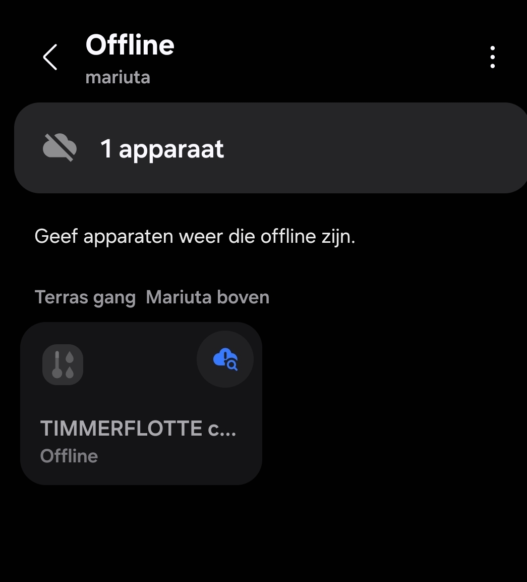

Now I pulled the batteries out of a Matter Timmerflotte temp sensor, and till now no notification from Smartthings. But after few minutes…..showing offline on the apps homepage at last..
So no a notification from the app.
