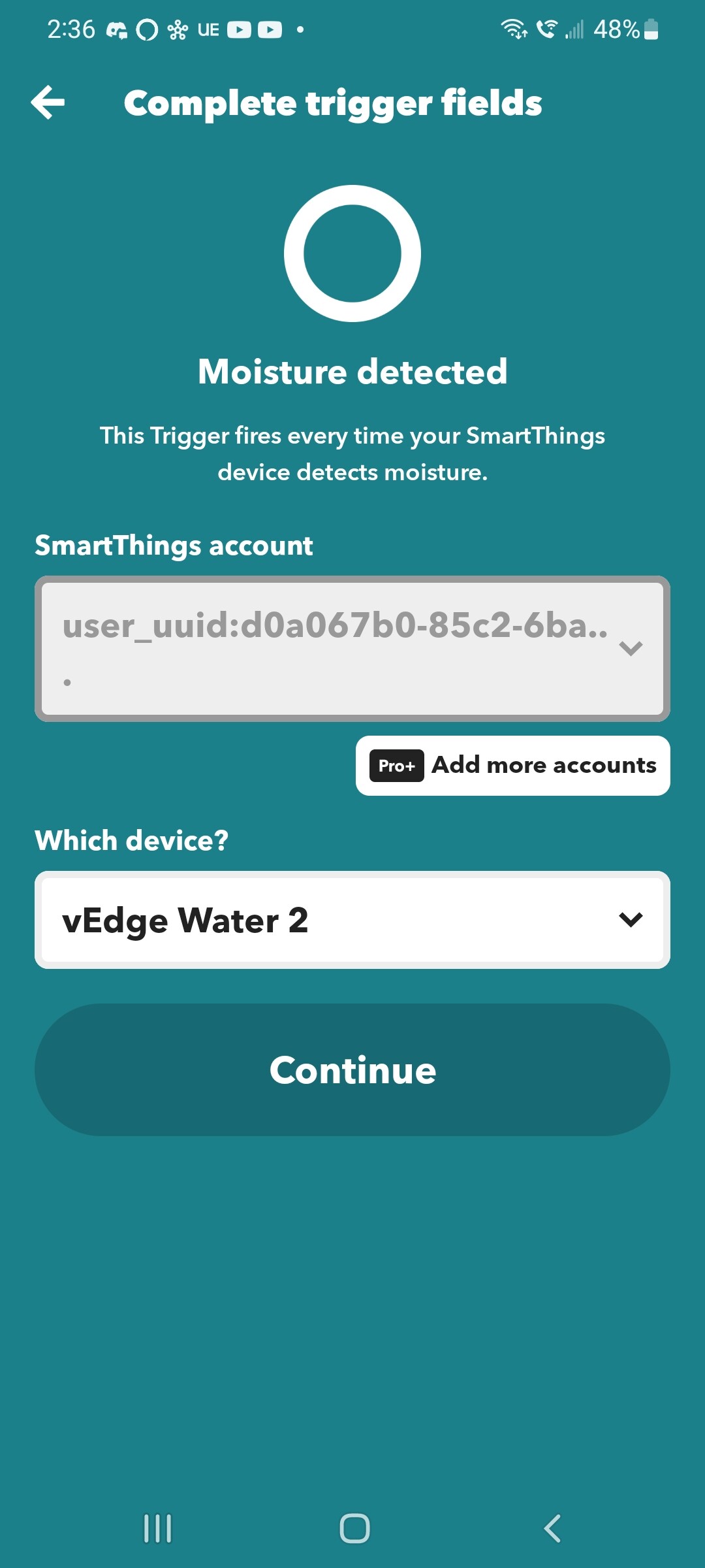

None of my DTH or Edge based leak sensor devices show up in IFTTT when creating a “Moisture Detected” trigger.
Looks like some capabilities aren’t mapping to the IFTTT triggers.
Actually I take that back.
I went in and reconnected IFTTT to smartthings and had to re-select some of the leak sensors. Both DTH and Edge based devices are selectable on the auth list and appear for “Moisture Detected” comparisons.

IFTTT will request for authorization, choose a location, pick your devices. Edge leak sensors worked just fine.
I created a virtual water sensor from TAustin’s driver, went into the IFTTT Linked Services in the ST app and added it as a water sensor
And it shows up in IFTTT
I’m able to do this with the Edge leak sensors too now. Maybe from my ST side it got out of sync. Now the ST app->Linked Services->IFTTT list and the IFTTT app->Profile->My Services->SmartThings list are 1:1 and the devices work as expected. :man_shrugging:
