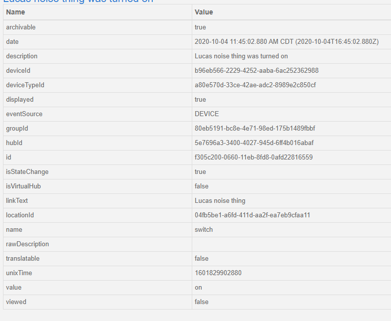

So I have a device that randomly turns itself on during the day. I’ve checked ALL of my automations, scenes, and smartapps. From what I can tell, nothing is triggering it. When I look in the IDE, it looks like it’s somehow triggering itself. The device is a plug-in dual-outlet switch, and only one of the outlets is doing this.

Also, In the ide event list, you can click the event and it might provide some additional details.

The device type is “Z-Wave Binary Switch Endpoint”. The details for the event in the IDE are screenshotted in my OP. It’s behind a bookshelf, so there’s no way the button could be pressed. The ST classic app only says “Device was turned on 11:45am”. The SmartApps tab says “No Installed SmartApps”.
