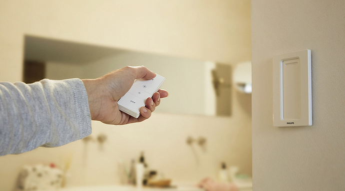

In the meantime though I do have one of these Philips Hue Dimmer Switches (https://www.amazon.com/Philips-Dimmer-Switch-Installation-Free-Exclusively/dp/B076MGKTGS/) any chance I can somehow hack it and make a longpress on the “off” or “on” buttons trigger the August lock to unlock + Echo to make the announcement? Longshot but worth a try…
Do you also have the hue bridge? Or only the dimmer switch?
I do have the Hue Bridge as well indeed. Sorry should have mentioned
In that case… You can’t get directly to the echo, but you can unlock the August with the Hue Dimmer by using HomeKit if you happen to have an iPhone. Assuming you have the August bridge as well.
Interesting, unfortunately don’t have the HomeKit/iPhone. But I’ll try to see if there’s any way to somehow hack the hue dimmer switch to get to do what I need, while I wait for these buttons to arrive ;).
Thanks again for your ideas!
You can do it by using a Phillips hue bulb as a proxy. Have the dimmer switch turn on a specific Bulb that you don’t use for anything else. Have that bulb coming on trigger everything else you want to have happen via The same method we were discussing for the smartthings button. I know this sounds weird, but it does work. :sunglasses:
Otherwise, you can try to get the hue dimmer to work with smartthings, but most people have found it’s just not very reliable.
