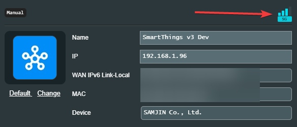

This is from the router, might be able to get something more definitive from command line. I have never had this be wrong. The Wireless “log” breaks it down between which SSID and radio the devices are on and this hub is clearly on the 5GHZ
Wireless Log (headers in separate shot because its a huge list)
