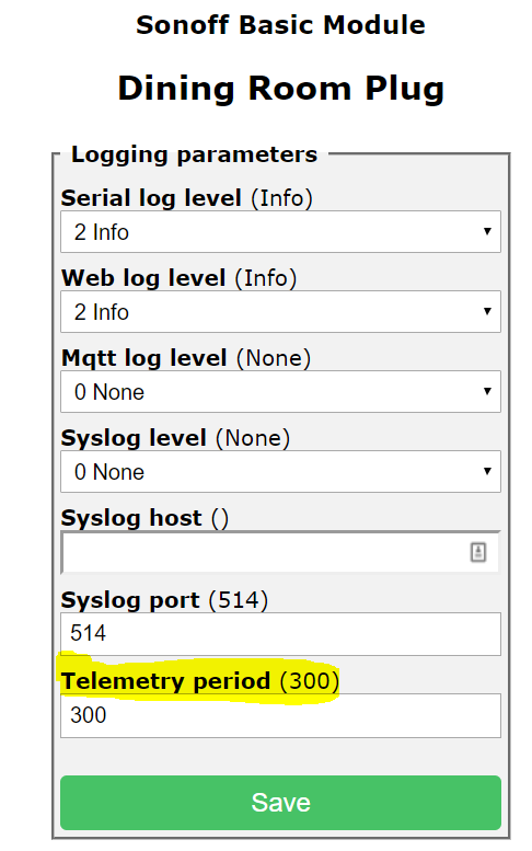

I assume that your Sonoff has been Tasmota’d. Five minutes is the default Telemetry Period and is adjustable. Goto your device’s IP address with a browser --> Configuration --> Configure Logging --> Telemetry Period.
Flashed with Eric’s file. Has update interval of 60.
