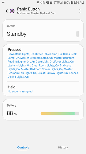

When joining another device of the exact same model and firmware release of another existing device, the IDE does not have the same “Current State” capabilities or “Data” values. This results in the device not having the same functionality in the new app, such as Quick Controls for the button(s). See the attachments.
“garage_button_ide_settings.jpg” shows the missing capabilities to allow this button to work correctly in the new app, such as the Quick Controls section (and Data). This is the new device I’ve joined. I’ve tried joining this multiple times, through both the new app and Classic.
“panic_button_ide_settings.jpg” shows how the device is suppose to look with the correct current states and capabilities. This is the existing device that works fine:
“Screenshot_20200303-170504.png” shows the device in the new app attempting to load the Quick controls section.
“Screenshot_20200303-170511.png” shows the failed loading of the Quick Controls section.

The Zigbee Button handler looks like it is still rooted in the ‘classic’ environment where the ‘button’ attribute had ‘pushed’ and ‘held’ values and button numbers were added to the event data to allow for things like double clicks. The ‘new’ environment adds shed loads more values so that approach isn’t needed (and the Automations don’t support it), with the ‘supportedButtonValues’ attribute being used to specify which of those values are actually used. It has to be set by the device handler and the Zigbee Button handler doesn’t do that.
The only other difference I immediately see is that the ‘Panic Button’ also shows a ‘checkInterval’, which doesn’t make sense in combination with ‘DeviceWatch-Enroll’ and the combination certainly wouldn’t be used by the Zigbee Button handler as the ST developers know better.
So I would suggest that the ‘Panic Button’ has been set up (temporarily or otherwise) with one or more different handlers at some stage and it has picked up those attributes in that way.
Unfortunately swapping device handlers temporarily seems to be a standard technique for getting devices to update their metadata. It isn’t a good one as it pollutes the device with stray attributes. Temporarily changing the name of the device works just as well in my experience.
Yeah I could do that, but I’d lose the Quick Controls for the button, which means I’d have to reproduce as an Automation. I’d be ok with that if quick controls were going away, but I’m not changing anything until I hear back because that’s super inconvenient.
Also, for the zigbee smokes, ‘checkInterval’ is there for all of them, but not the device enroll, so I see what you mean by that. The new one is just missing “meshInfo”(not even listed). I’m actually ok with that because it’s not impacting anything.
I’m not sure if I put my point across well enough. Just in case, what I am saying is that nothing unusual has happened with the pairing of the Garage Door Opener. It only looks different to the Panic Button because at some stage the latter was installed with one or more different handlers that set the ‘checkInterval’ and ‘supportedButtonValues’ and they linger. There could be other stray attributes too. The IDE only shows the ones associated with the current handler. So basically the Panic Button only supports the Quick Controls by fluke.
There is an issue here, but it is that the Zigbee Button handler needs updating to work with the ‘new’ app as several other stock handlers have been.

Is the expectation that “Garage Door Smart Button” will support Quick Controls? I would not expect that for Zigbee Button devices as they have an ocfDeviceType of “x.com.st.d.remotecontroller”, which is demonstrated by the remote icon for the device.

Yes, that’s my expectation since my other button devices (other Iris and Minimotes) have that capability. Here’s an Iris button. and the one below that is a Minimote (created in January using stock DTH), and the stock DTH for both has ocfDeviceType: “x.com.st.d.remotecontroller”:
The DTH for the Minimote was last updated in your Github repo on Dec 13, 2019, and the Zigbee DTH was updated on Dec 3, 2019.
