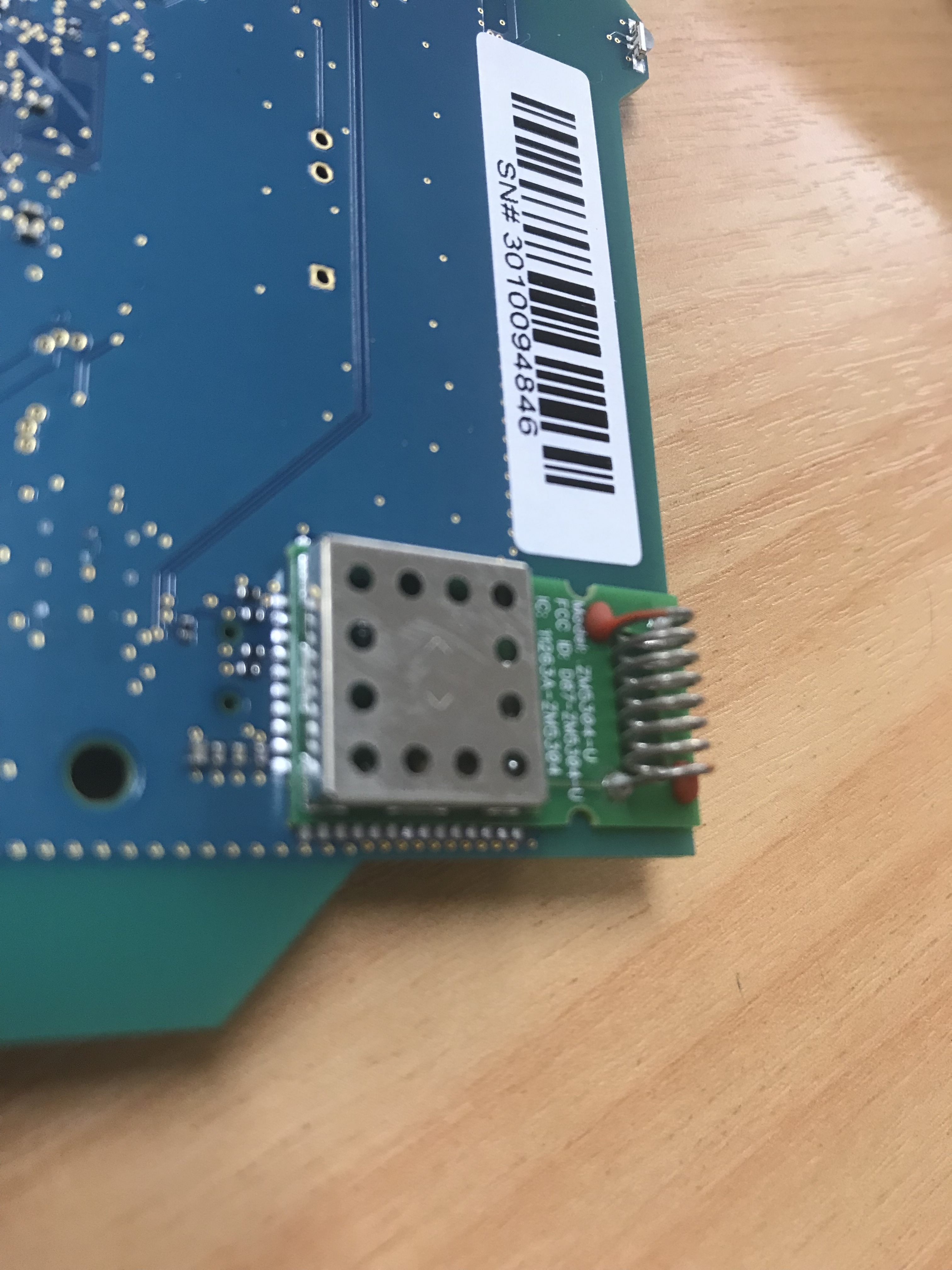

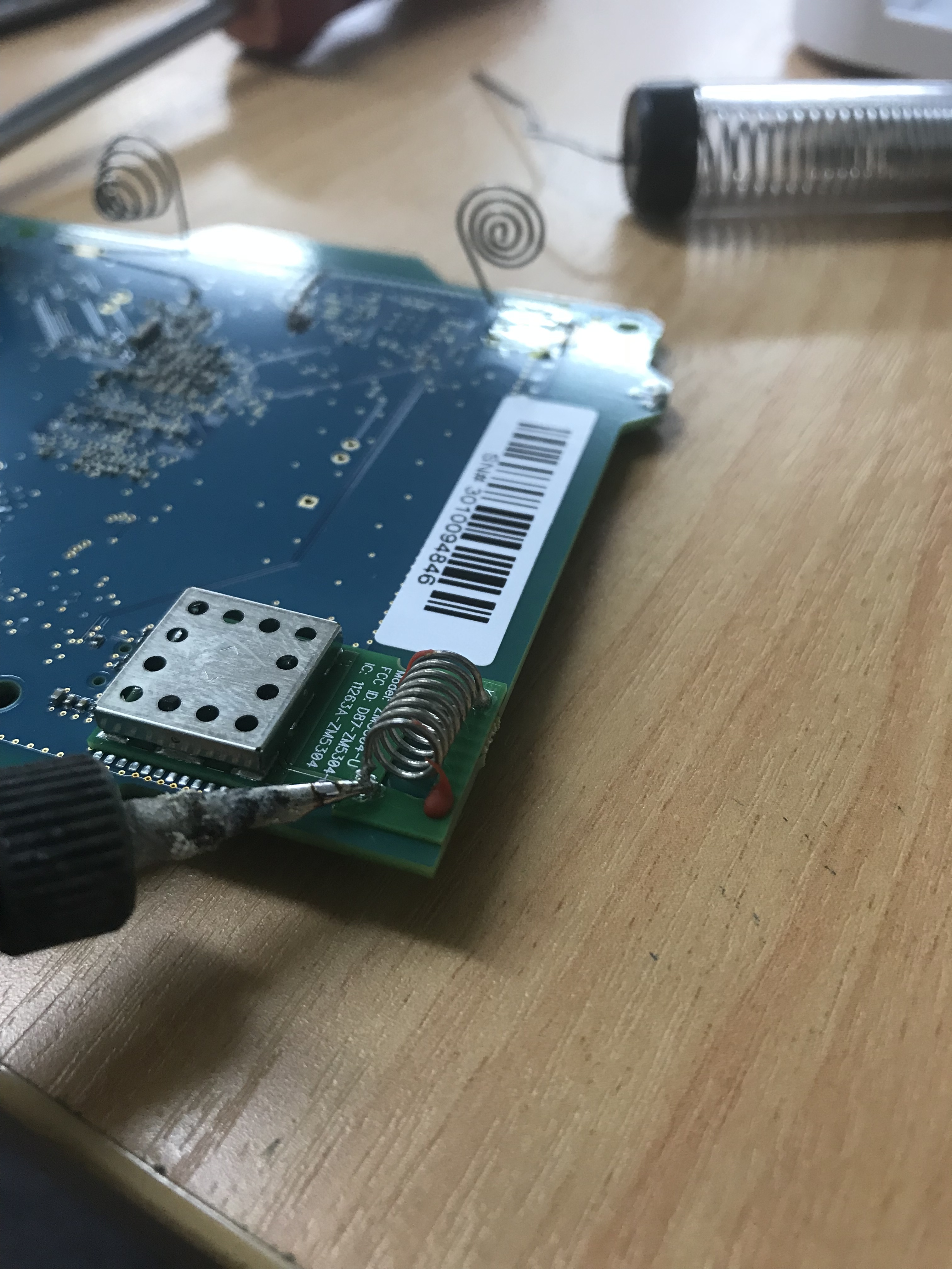

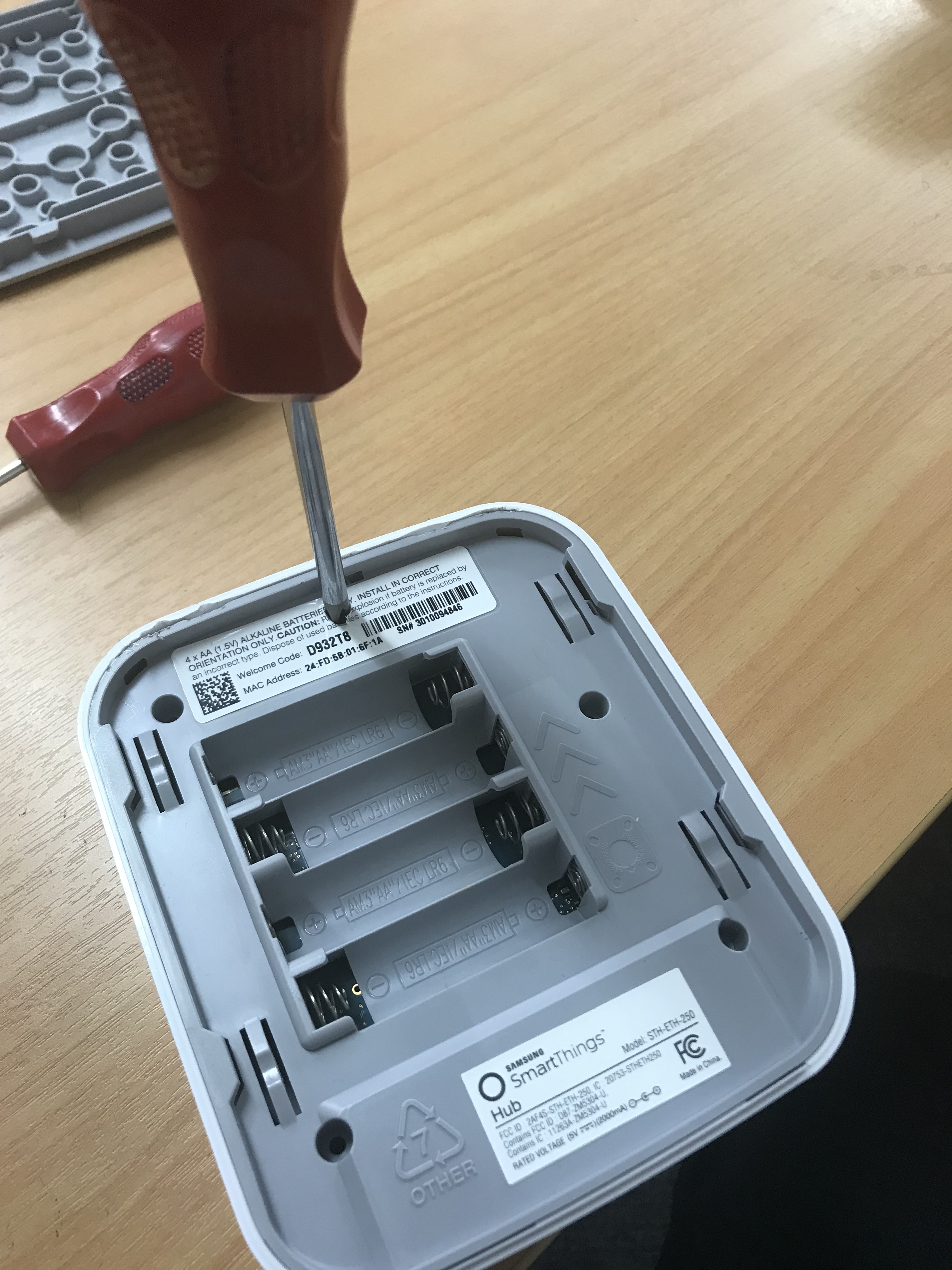

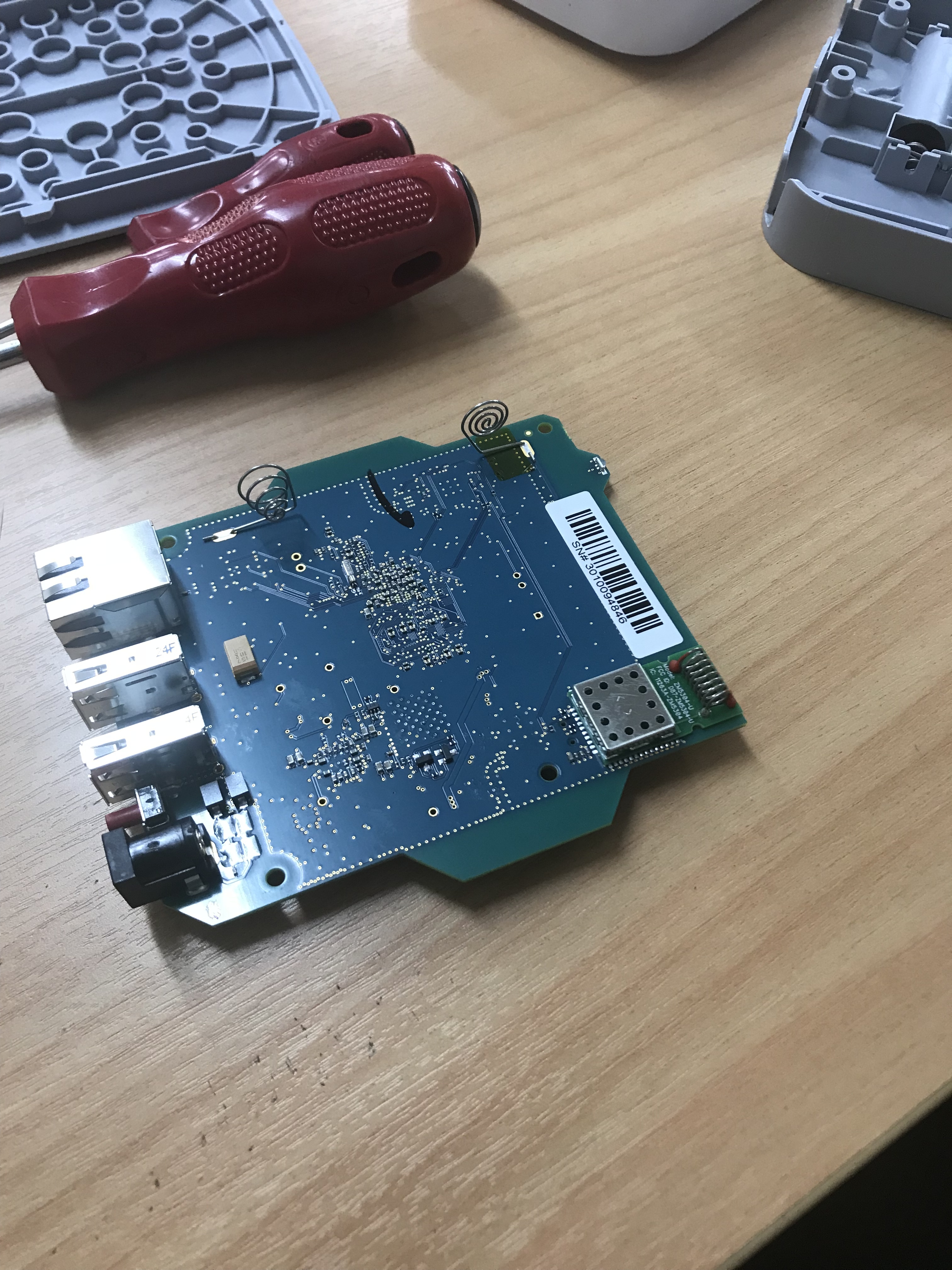

Well I finally got some free time to look into this again. I decided to brave it and pull open my smartthings hub to remove its US Z-Wave capability. I’ll check back soon with the results.
I cracked mine open and unsoldiered the z wave aerial. Turned it off in the software so hope that should be ok.
Well I just snapped mine off and didn’t change any settings and it’s still working perfectly. Been using Zigbee sensors all day with no issues and even still paired a smart things zigbee contact sensor with no issues.
