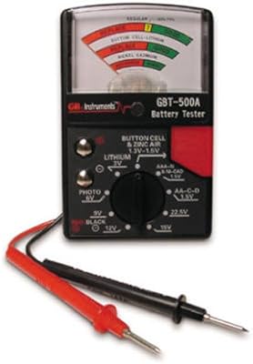

  1. How do check the status of a battery outside of ST? Is there a tester I can buy? Because I can’t find one that tests these coin batteries and the ST battery status seems extremely unreliable.

I have a battery tester from the 80’s from Radio Shack. Basic and is easy to use.
ST battery display is notoriously bad. Had sensors die with 67% showing yet battery dead. Meter is a good way to check for sure.
Most reliable piece of equipment I’ve ever owned, and I inherited it from my dad. (Not my finger.)
