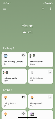

The first entry in the βstatesβ array is the one that is used to display the attribute status in the array. The other entries arenβt currently used by the app as dashboard tiles currently only support one state. In this case the illuminance measurement is shown first which was exactly what was required.
