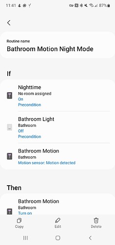

That’s what pre conditions are for. But I guess your problem is you need a triggering event to cause a Routine to fire… ?
If all you need to do is check if a device is current on/off, you can use a precondition like in the example below. If you need something more complicated, you can do as @csstup suggests using mulitiple routines.
Imagine that the “that” in your if this, then that, rule is a siren sounding.
“porch light is off” can’t by itself be a trigger condition in any home automation system, because “is off” isn’t an event. It’s a state. A trigger has to be an event.
Now you could combine it with checking, say, every minute, or every 15 minutes, and have the siren go off because the porch light is off when you go to check it. But going to check it would be actually triggered by the time interval.
That’s what people are describing with a pre-condition of the porch light is off. If the porch light is off (state) and a trigger event occurs (like a specific time or a specific time interval, or someone arriving home, or the door being opened or whatever event you were using) then state could be a filter on that rule happening, if the door opens and the porch light is off, sound the siren. But there has to be an event to be a Trigger.
