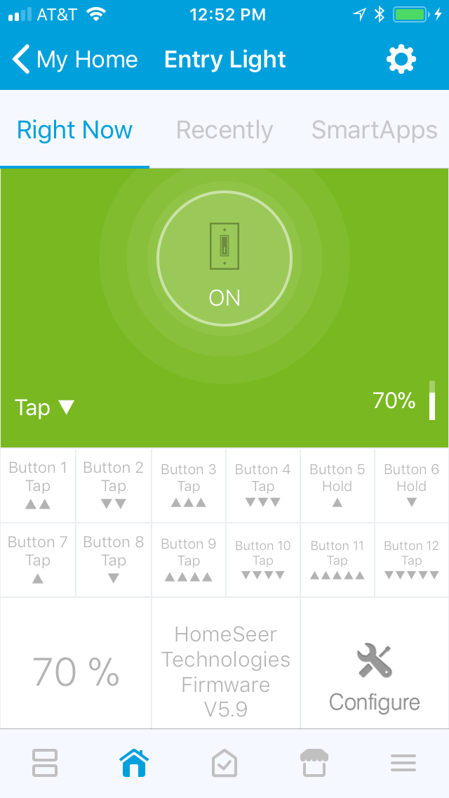

@Darwin. Request for the DTH, add the button number to the Tap ▲▲ label. I am always having to cross reference ;‘if I triple tap up, what button is that?’ Maybe something as minimal as
(3) Tap ▲▲
or
Tap ▲▲ (3)*
FWIW, not even sure if double up is button three- just example above.

Good suggestion. With all the recent button additions, I haven’t been able to keep them straight either. I updated the DH virtual buttons to include the button # and also cut down their size to reduce clutter since there are now so many of them. Downside now is you may need reading glasses and skinny fingers to use them. Let me know if it causes any issues.
Do the buttons (i.e. Tap ▲▲) actually do anything in the handler? I’ve only gotten the dimmer slider to work. I don’t see anything with logging when I press one of the Tap or Hold buttons.
Yes, if you program them to do something when pressed. I have the older generation switches and dimmers and use the Advanced Button Controller smart app to assign other activities to the double, triple, etc taps.
OK, very odd as I would think pressing the Tap ▲▲ button would turn the lights to full brightness which is what happens when I double tap the paddle switch. I guess they’re two different events…
