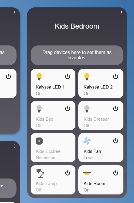

what happens if you login to my.smartthings.com … do they load there?
Works fine…
